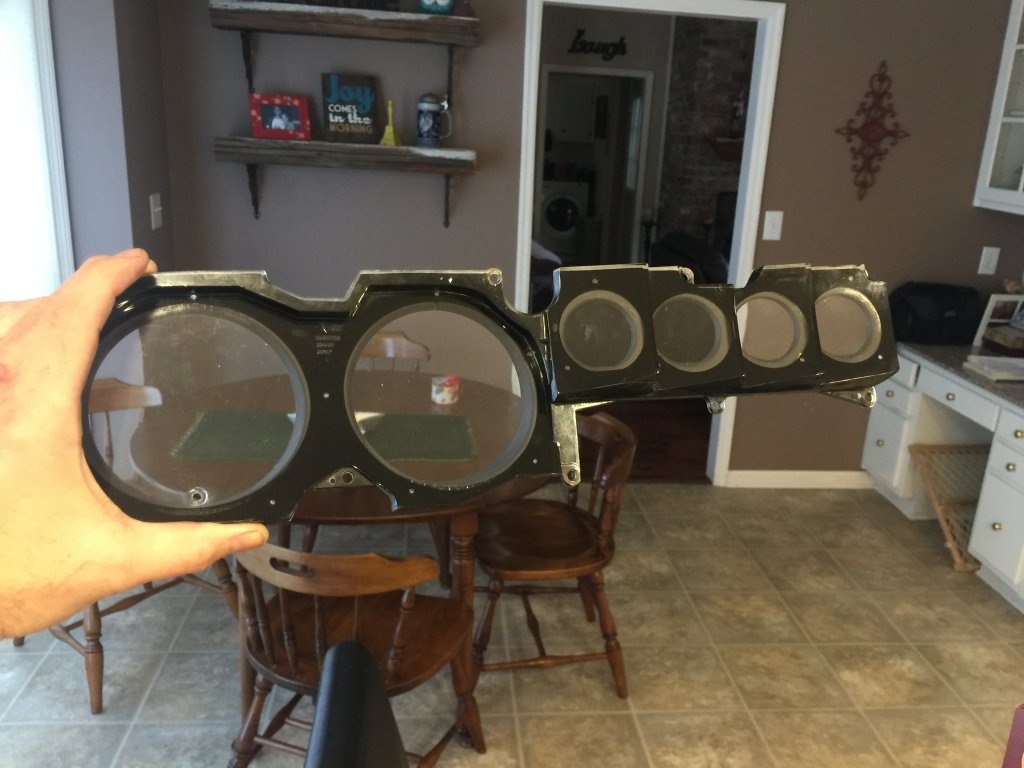

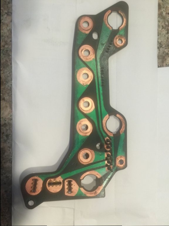

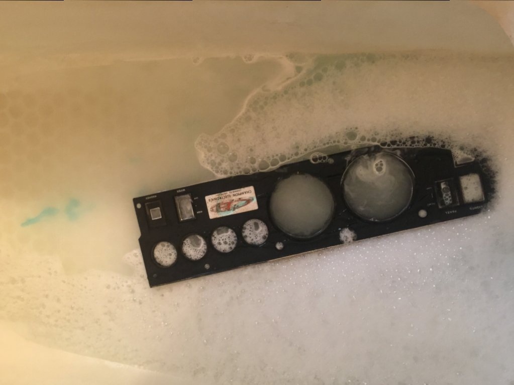

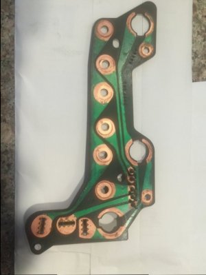

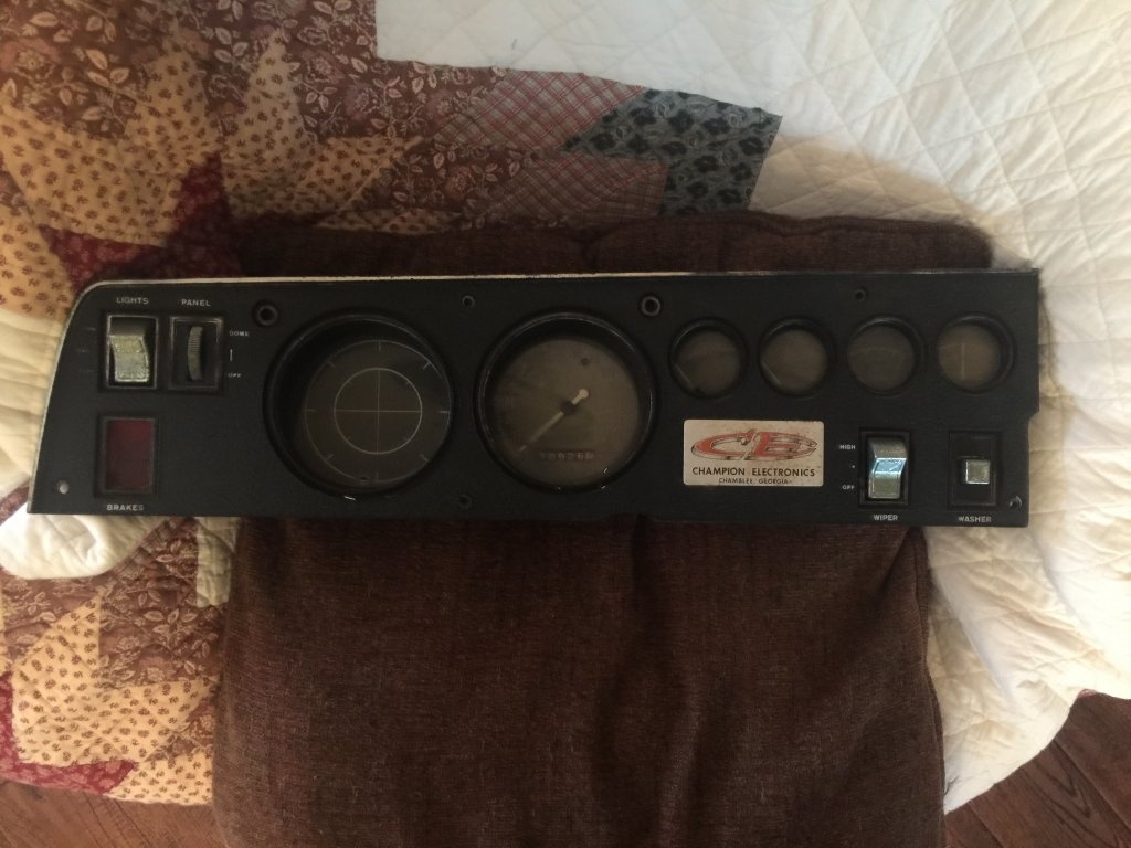

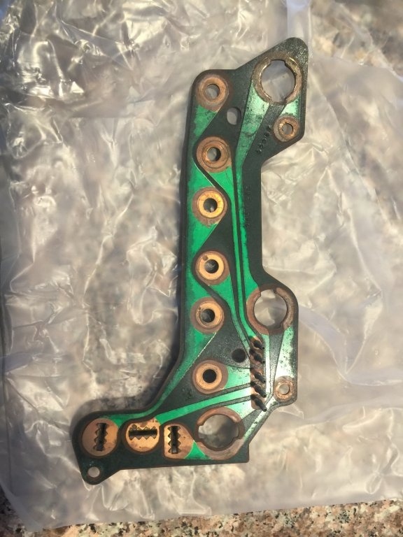

Thanks. It is a new sensor but I haven't spent any time inside the car just yet but will.I did test it to ground and nothing so I need to dig into the cluster.You can check the gauge by quickly grounding the sensor wire. If the gauge goes to hot it is working and probably the sender. Don't keep it grounded or you can fry the gauge, just a few seconds.

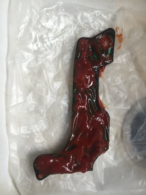

Only the best acid to clean! Do you have a link to said mod? I suspect the regulator was bad since all were dead.Is that ketchup or catsup? lol
There is an electronic gauge voltage regulator mod you can do to replace the points style unit, makes the gauges rock steady.
http://1962to1965mopar.ornocar.org/ml-instrument-voltage-regulator64.htmlOnly the best acid to clean! Do you have a link to said mod? I suspect the regulator was bad since all were dead.
I did this on my 62 and it is going strong. Your 3 prong setup looks the same. I found my parts at Mouser. I used some old pistol brass flattened out for the plug in connectors.

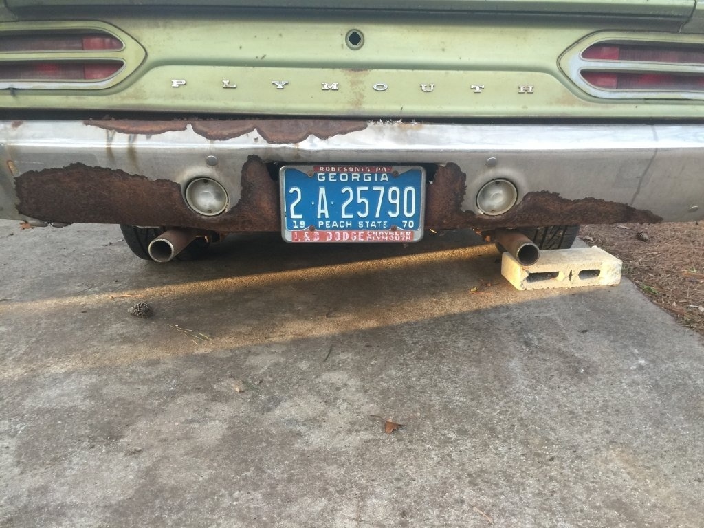

i got 2 1/2 inch factory chrome tips for sale if you want a set.That's cool....
Thanks I am going to have my exhaust guy build a new set up. Not sure what that will look like yet.i got 2 1/2 inch factory chrome tips for sale if you want a set.
They look bitchin though!Nothing like School bus yellow Slapper bars that do Nothing for Mopars
I think so, goes with the car.They look bitchin though!
