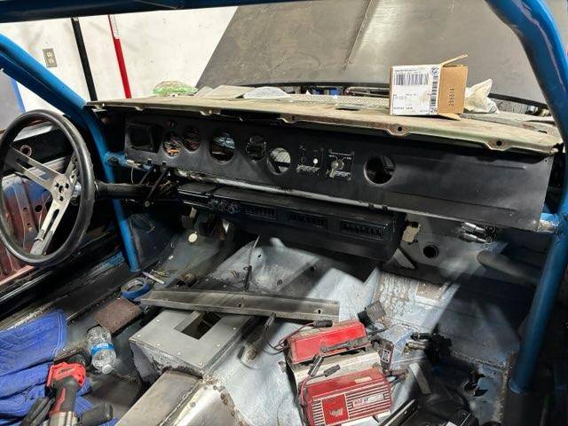

Can some please give me the width of the dash pad. Looking to order a new one but not sure if it will fit between roll bar. If I have to cut it down would rather do it to a old one.
The dash pad from my 70 GTX measures 51 3/8 inches wide measuring straight across the front. The "ears" that fit under the A-pillar moldings are another 3/8 inch on each end of the dash pad.
FWIW, I've seen several repro pads that are too narrow between the pillar moldings.
The ears should tuck in & not be visible.
