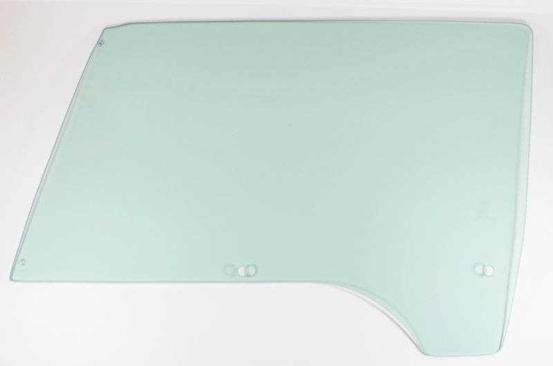

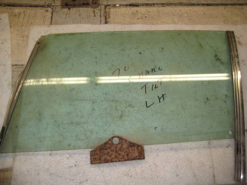

The glass itself is different between a post and a hardtop. The vent windows should be the same. The hardtop glass has the trim piece that makes up the gap between the quarter glass and the door glass.
This is a charger hard top glass. Edit previously posted wrong glass for the post car..

Agree with dadsbee...post and non post cars different glass
This is a Coronet Post car glass. Which should all be relevant.
