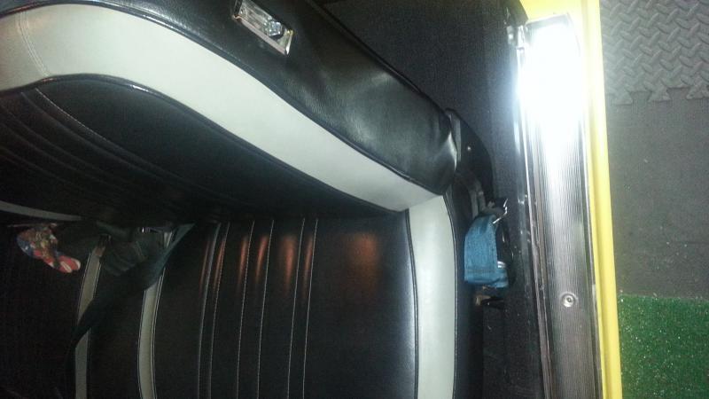

20140710_084704.jpgYea! Thanks for the replies :) I am very visually oriented in my thought process, and I can see the proposal I put forward working. The only notable concern I have is where I am going to mount the retractor, but I think I have room right behind stock one (see pic) NOTE: all of this will likely change when I go with bucket seats and a console (not original to my car, but way better looking and more comfortable from a performance standpoint, they "hold" you better)
25 years ago I put buckets in froman 89 fwd Daytona in a wrecking yard. They are still in adn starting to wear. The retractor is forced back due to the proximity of hardware from the seat. That is why is needs a little help when stowing. When time to do it again, I wil go the way of Mr. Angry and get seats wtih the pass through straps that you put on like suspenders.
