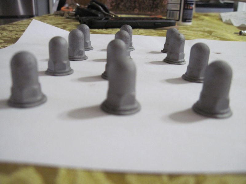

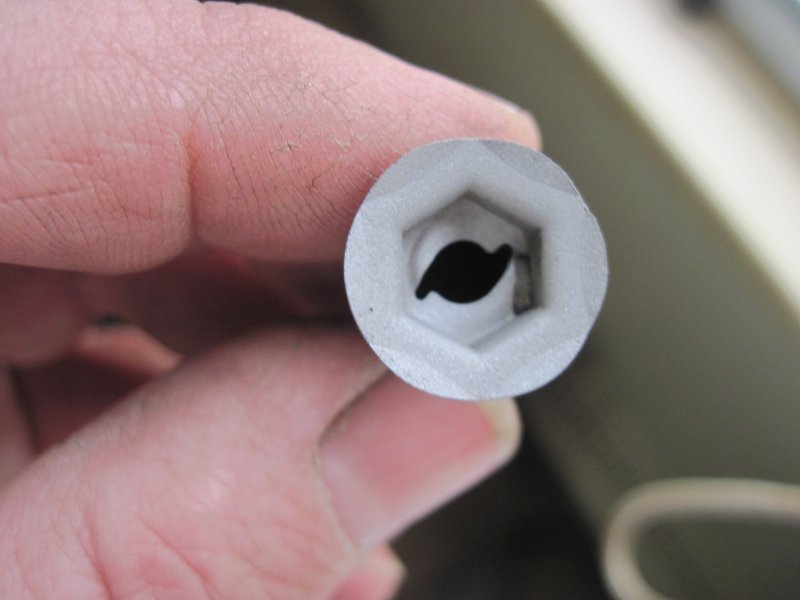

Does any one know where the best place to get the nuts that hold the taillight in on a 70 Roadrunner? The thirty dollar Ebay one only want to strip out the studs. Thanks
R/T Specialties
Send me a picture of what you need, I have a few originals I would be willing to sell
#3. If you cannot contact them, go through a vendor like Stephen's Performance .

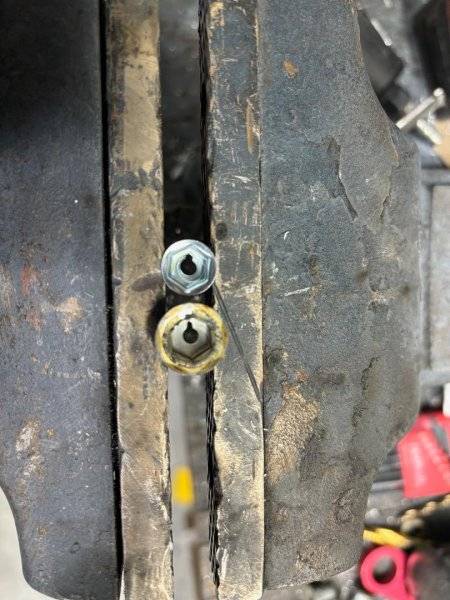

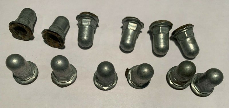

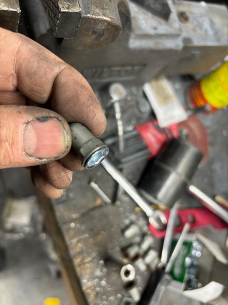

These are the ones I got off of ebay. It seems like the speed nut is too small. I was able to pull the nut out of the cap. So I ordered some 10-24 speed nuts from McMaster. If they fit the studs I can put the cap on them. We will see on Thursday. Thanks

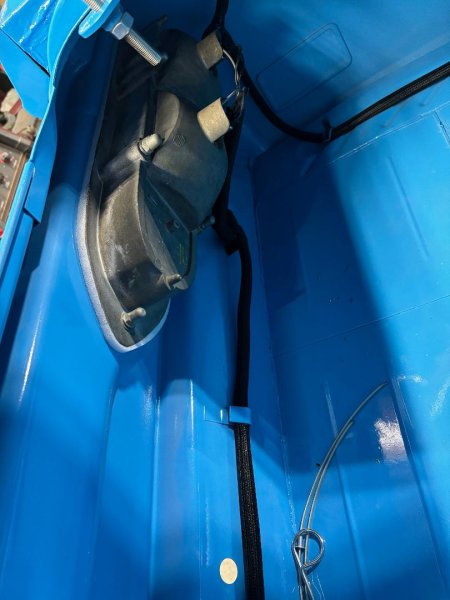

I swapped out the speed nuts and it worked.
