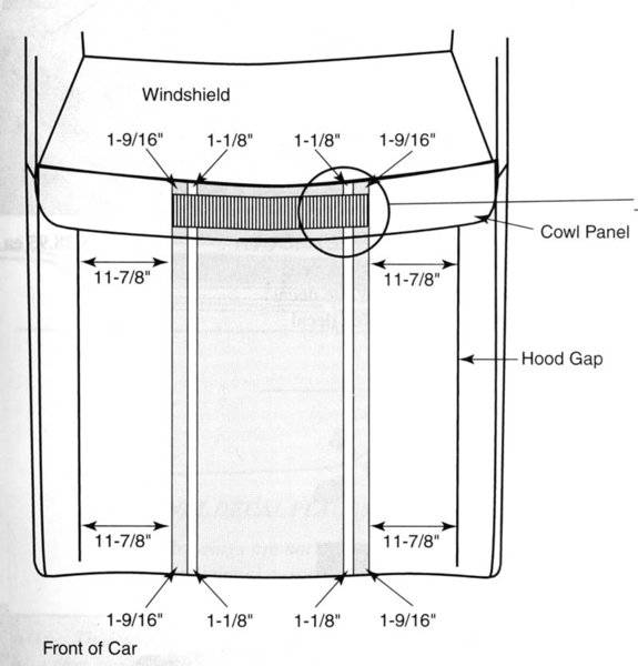

Black, except the top is painted either body color or flat black depending on if you got the stripe treatment. This included painted blackout on the hood plus the transverse stripe on the trunk.

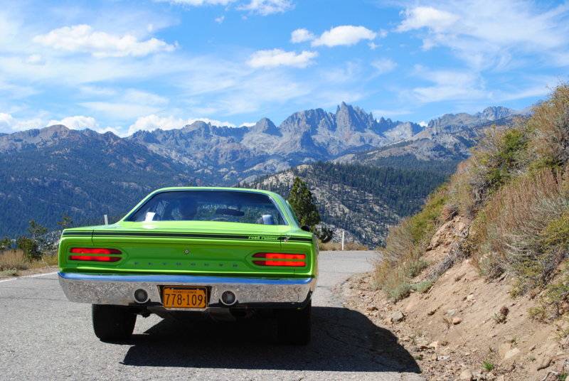

Which transverse stripe on the trunk would that be on a road runner?
This is the rear stripe
This is what it looked like from the rear without the hood and rear stripe. These cars received a metal road runner emblem with corresponding holes in the trunk that the stripe cars did not have.

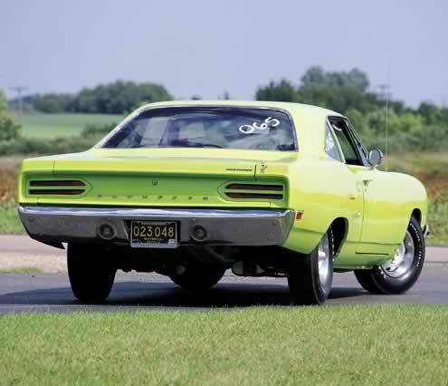

If I remember correctly, they were black, white or gold. My black one is reflective too but I have a faint memory they were also available non-reflective.
I actually really like the reflective properties of the stripe. If I have to park the car on a street at night you can really see the car well from behind. It's a nice safety precaution to avoid getting the car smashed!!! :thumbsup:
Here is a shot where the sun caught the reflection - makes it look totally different!
