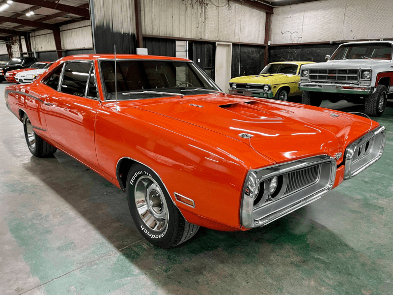

I really like the 1970 Super Bee R/T pitchfork hood scoop, and was wondering if a 1970 hood could be modified to fit a 1969 Coronet 500. Is there a good way to install the 1970 scoop on a 1969 hood?
there is no way to modify a 70 hood to fit a 69. Find a wrecked 70 hood and start cutting.I dont see anything wrong with this hood
Cutting and welding.
As much as I like the 70 bulge hood (which can be made functional fairly easily), I have to say the 69 functional scoops are my absolute favorite hood/front end look on any car ever-

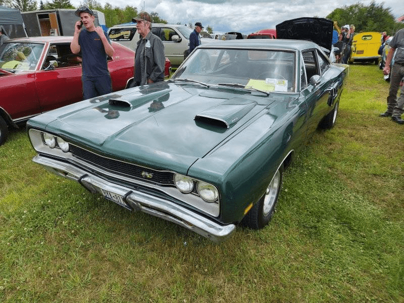

I think this is the hood he talking about
I see no reason 2/3 of a 70 hood skin can't be grafted onto a 69 hood........ even that center rib looks like it cooperates.....
looks doable to me; I'd be like, "hold my beer"
It looks like the fenders on the two are very different. '69's look molded to meet the raised front, and '70's are flat, with an aero dip to the grills. I'd like to see one matched up for fitment...

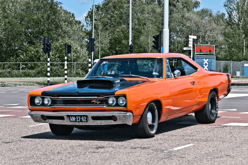

I've seen 70 bulges grafted onto Superbirds (and they look pretty good), 70 Chargers, and a few other things.
