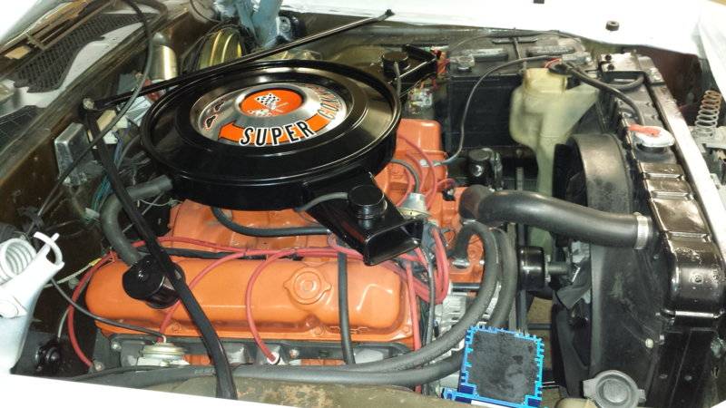

Agree. 71 didn't have them. However, it doesn't mean you can't add them. I grabbed a set from similar year charger and made them work. Had to make " Custom" bend on the passenger side to clear the base plate.

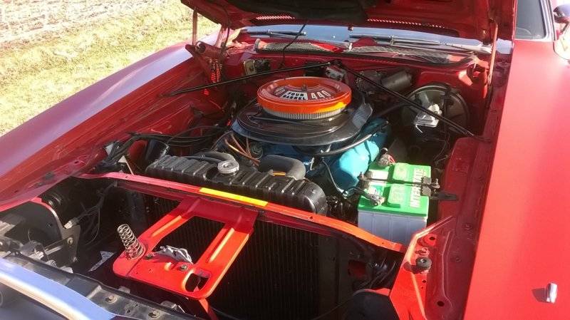

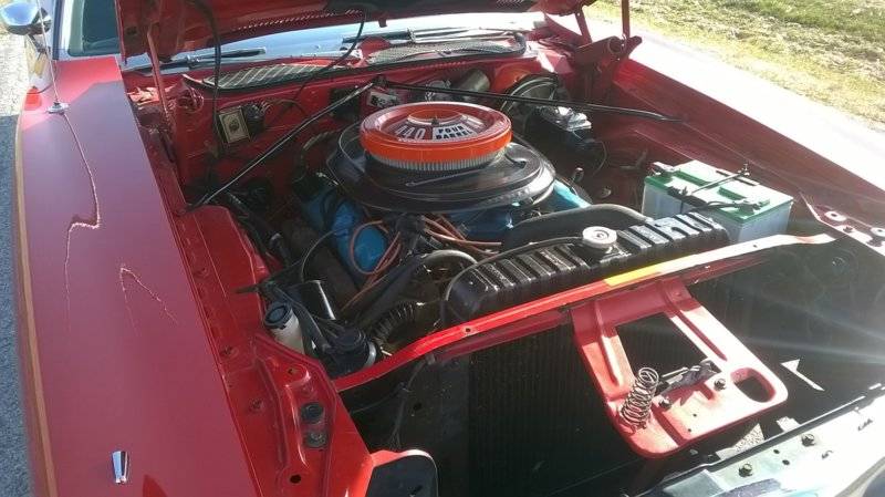

Unfortunately, those aren’t the correct ’72 one year only struts pictured above in that shot. Missing the hood hinge clearance bends and the mid bend on the passenger side strut.
Other than it was straight it sure looked factory. It wasn't a 73/4 bar.

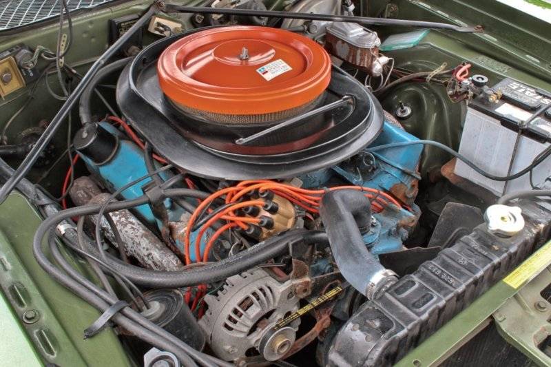

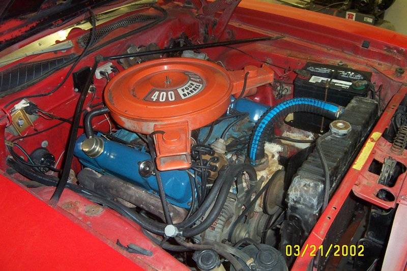

My 72 SSP has a curved bar.

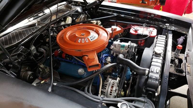

These are ‘73/74 struts trimmed down to fit a ’72. Slight bends added at the ends to allow the hinge clearance. Didn’t bother with the mid bend on the passenger strut, not needed.

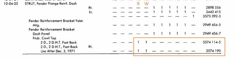

To be clear, beginning with ’72, the center cowl stud and reinforcement plate was present on all ‘72s, not all cars had the struts installed from the factory however. Only saw them back then on big block cars, with and without N96, personally. Others believe some 340 cars got them; others indicate not with N96. I have also witnessed many of them being removed and discarded at the dealers back then if they got in the way.
Have yet to locate any documentation from the time that addresses the factory application of the struts. Parts books are typically pretty good at noting specific applications, not in this case.
Note part number change on the right side strut Dec 3, 71.

I think we have talked about this before. The ones on the blue 72 GTX sure look and fit like factory ones other then the right side is straight. Maybe the right bar is actually a left bar? Don't have the car anymore so can't check.
My 72 SSP is a 400 car and the bars were on it when I got it and they look like the other 72's I've had.

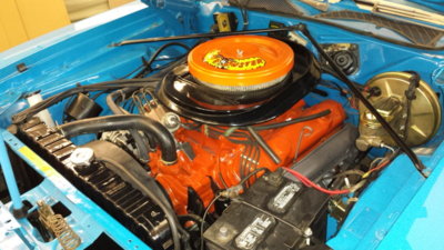

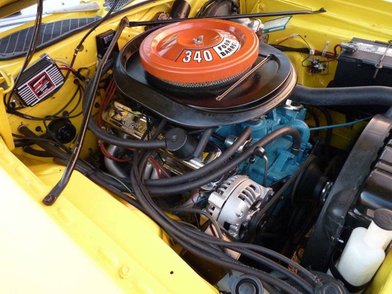

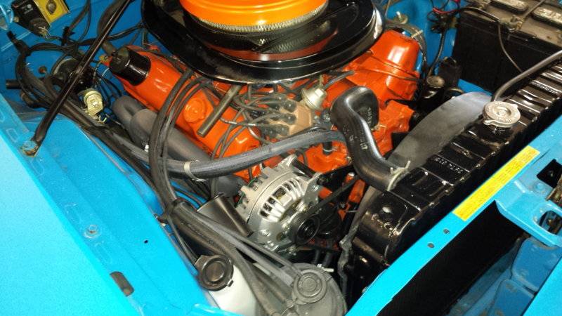

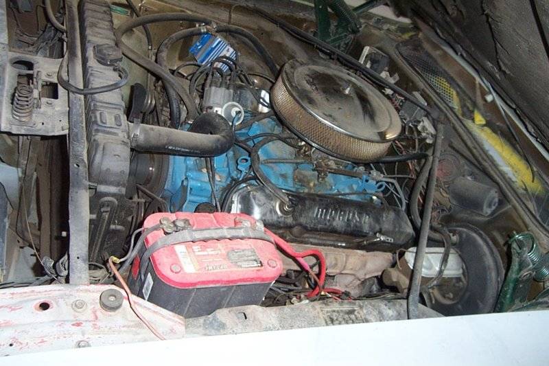

Good luck locating them. They were one of the last parts I found when restoring my 72 RR.
I was real happy that my car still had them when I bought it.
My 72 RR had them as did my 72 Charger Rallye 440

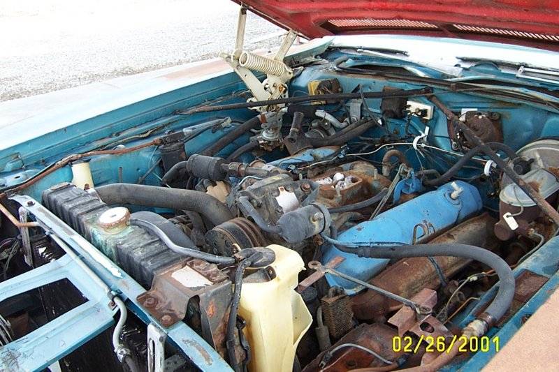

Have had several 72 318 cars that did not have them.
