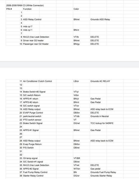

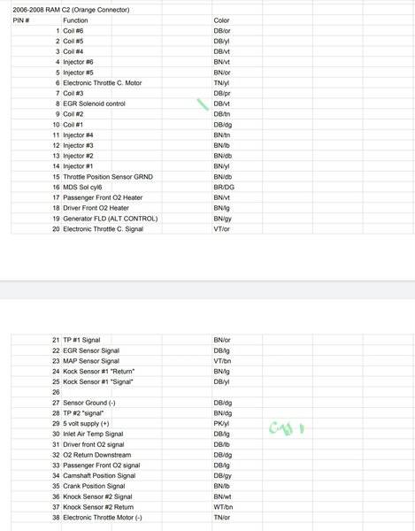

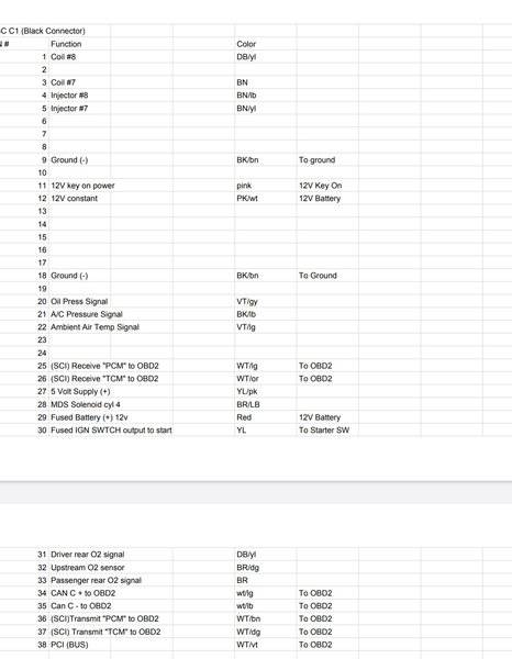

I am using a Holley Terminator X harness for my 5.7 going into my 71 Charger, I wanted the tunability capability but I like that you took the time to figure out what is what and opened up a harness, most would be too intimidated by all of those wires.
Honestly its not hard. Blake at diyhemi did all the hard work by labeling all the wiring and telling exactly what each wire does. What i didn't know was that the c1 connector/black connector u have to have wire 11/12 tied together in order for the engine to run. Shelbydog channel helped me on this.
