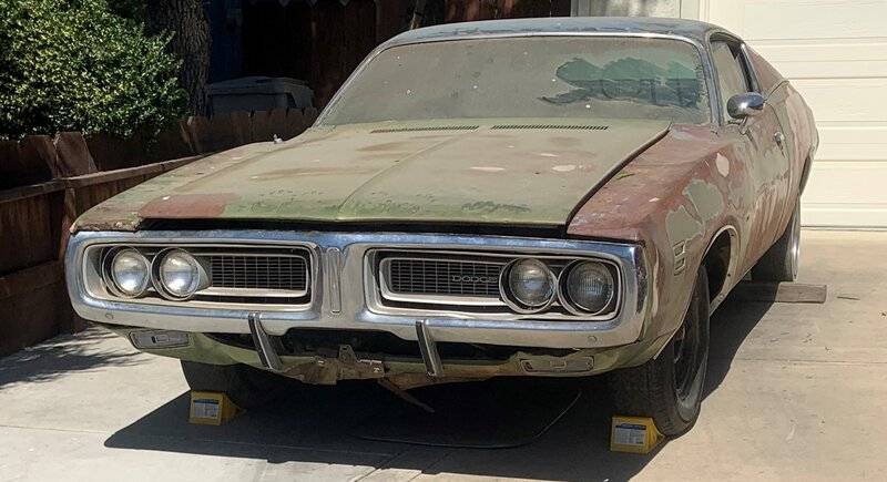

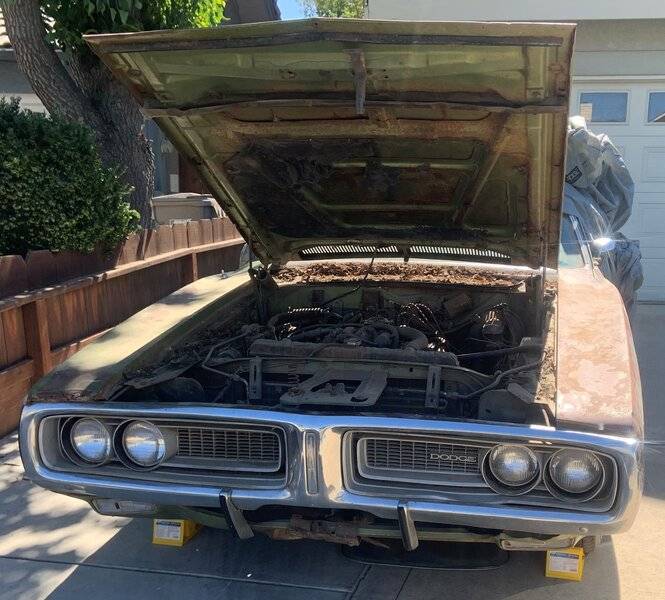

Here are pictures of my 71 Charger:

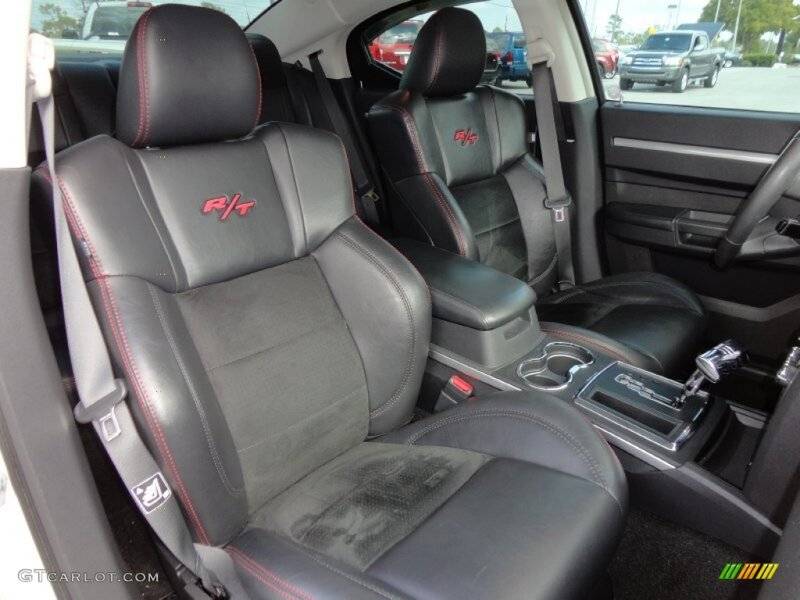

Some potential seats I would like to put in my car (2009 Charger RT) (also, I would like to use the back seats if possible):

Also, the Charger back seat will fit right in, you will have to make a way to fasten it in, the front seats, like mentioned previously, will be too tall to work right. There are other modern options that work well though
