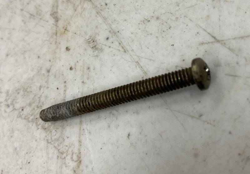

does anyone know the proper screw for 71 charger R/t - 500 tail light bezel screws ? or if anyone sells a kit ?
8-32 x 1-5/8" Round Phillips head. Head diameter is just a tad over 1/4". Black phosphate in color. Originals are self tapping but that should not matter unless your dealing with untapped NOS housings.
thank you !!! now the search begins !
I bought 1 1/2 ones at the local hardware store, a few of them weren't long enough. Finding them in 1 5/8 inch might be tough. Maybe you can get them in two inch lengths and cut them to size. If you do that spin a nut on the screw first, then cut them and spin the nut off and it will clean the threads off on the way off.
possible they might be the same as other mopar taillights?
