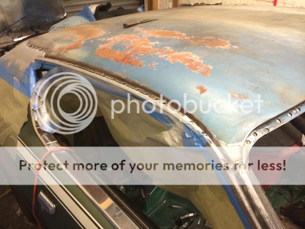

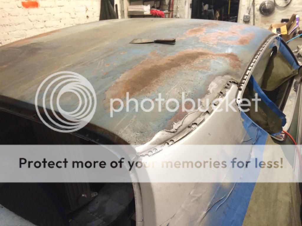

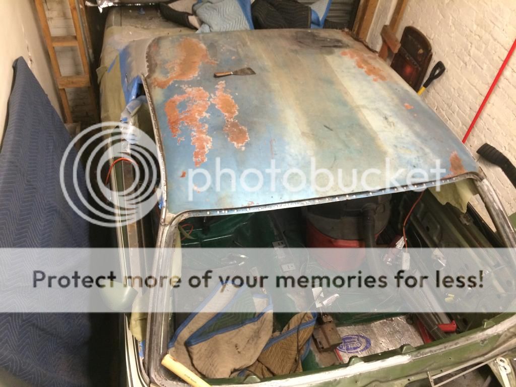

Taking the outer skin off was simplicity itself! Just a lot of time spent to drill out the spot welds. Boy am I glad I didn't pay a body shop for THOSE hours!
The frame is solid as hell underneath.
Follow the pictures....
Wow.
How did you get the spot welds free from inside the drip rails?
I bought 4 spot-weld cutters bit from Harbor Freight. I ended up only using 3 of them. They are $5 each.
For the drip-rail area, first hit the gutter with a wire wheel to expose all the spot welds. Once you get it nice and shiny they will become easily visible. Then you take a center punch and a nice heavy hammer and make a decent sized dimple in the middle of each spot weld. This is important as the spot-weld cutter wants to walk, BAD. Then you just drill out each spot weld, right down the line.

Just an update-- I finally finished skinning the donor roof panel off its frame (it was cut off the donor car at the pillars). After lots of careful drilling, the spotwelds were all gone at the roof skin just lifted off! What a thing of beauty that was.
Even more beautiful was the fit of the panel on my car! Fits like a glove!
