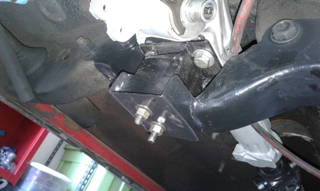

I had a similar problem on my 65 Coronet with 69 727...bought a bracket and a mount on E bay.
Here's a couple pics if it will help:
Get the conversion mount from Schumacher Creative Services.

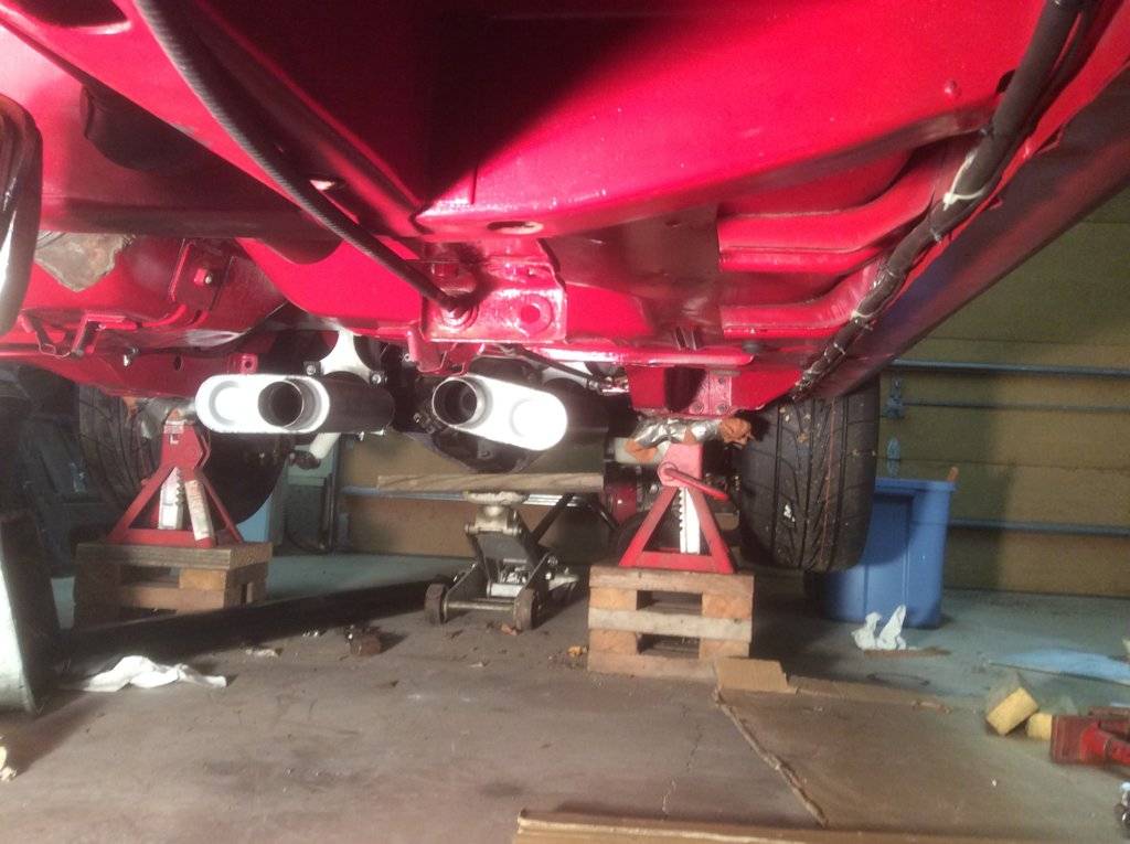

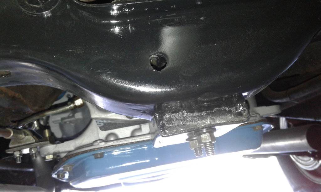

View attachment 519658 View attachment 519659
Thanks very much for this, can you tell me any part numbers or specific descriptions that will help me get to this part, it looks perfect. What did you do about extracting the emergency brake cable from the old cross member part? Again, thank you very much.

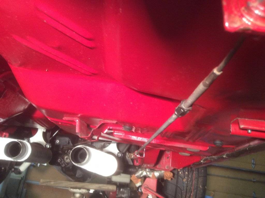

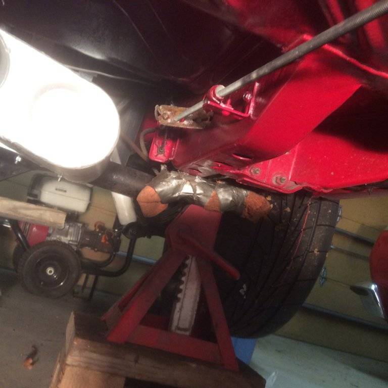

The emergency cable system could be converted to the 66 and later system. You need later cable from rear axle. You should have the two hole bracket on driver's side rear frame rail. You mount another bracket on trans cross member. I used a threaded rod and a connecting to connect front cable to back. Supported rod with plastic tube and a fuel line clamp. Didn't put a nut on where cables meet, it turned horizontal , lock nut on both sides fixed it. Third picture is front cable mounted to front cross member. Doubled pic's oops.
