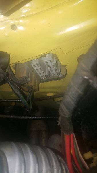

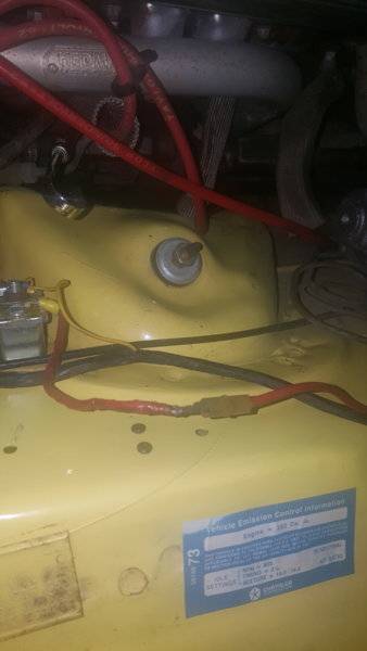

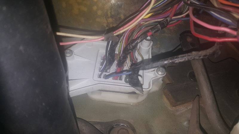

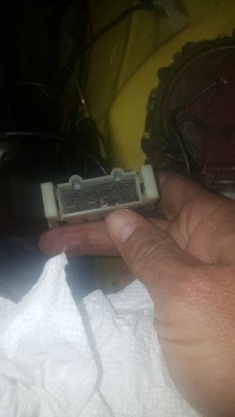

So, I picked up a pretty 71 roadrunner as a fun car. A few minor issues as expected but now I have a major electrical issue. Battery drains while at rest, wiring has been messed with over the years and is a bit of a mess. When I jumped the car the other day I noted the red wire coming to the firewall started to smoke. I pulled the cables and disconnected the bat.. Am I running a fire issue or just too much juice from the jumper cables?
A few photos. I think I need to wire past the dash gauge, thoughts?
You have 3 harnesses under the hood. Wiper harness, Engine and front end lighting. The rear lighting passes through the lower left kick panel and runs under the wire shield just under the sil plate all the way to the back.

well, it seems you got a short somewhere. and it got some previouslly to because that red melted wire should be blue being a fuse link... replaced maybe with a regular wire instead a fuse link ? wrong!
to get that wire melted like that is a bad signal... could be ammeter isolators meled and shorted to cluster housing ? practically 90% of the car is fuse protected but the charging system, ignition system and headlights... those are protected by the fuse link

on a side note, If is what I told ( ammeter isolation fail ) is just about replace isolations and the propped mantenience to the gauge. The gauge itself is hard to beat, but related stuff about the poorly charging system balance from factory causes damages all around, like bulkhead ( as you can notice ), and ammeter studs and terminals. Read this and understand how it works and what an amm reading means:

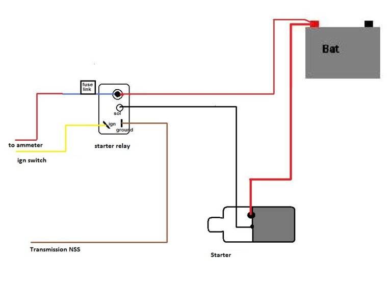

Also have a question on the starter relay. There are two posts on the bottom, neither were connected when I got the car. What are they for?
They are the relay’s primary terminals, one connects to the neutral safety switch (or clutch pedal switch for 4-speeds), the other is the yellow lead (starter) from the ignition switch.
Ahhh.. so this is why I could start my car while in drive. Scared the crap out of me when I did it on accident.. I will fix that connection too.
One of your above pictures appears to show the yellow lead connected to the solenoid terminal, not only will it crank no matter what gear, all solenoid current would be routed through the bulkhead connectors, dash wiring, and ignition switch. The primary purpose of the starter relay is to not have this current draw on those wires. Be sure the check the ignition switch Molex connectors at the bottom of the steering column for heat damage/high resistance.
about the burn spots... if damages are just on terminals and rest of wire are still good you can replace bulkhead itself allong with terminals ( male and female ) allong with isolators to make a full system refreshment instead get a full harness setup. Depending on your skills to make that
