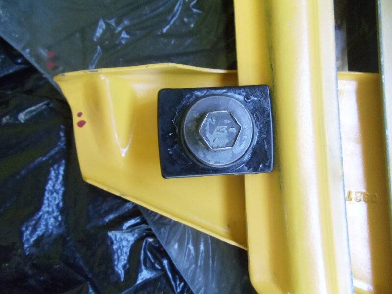

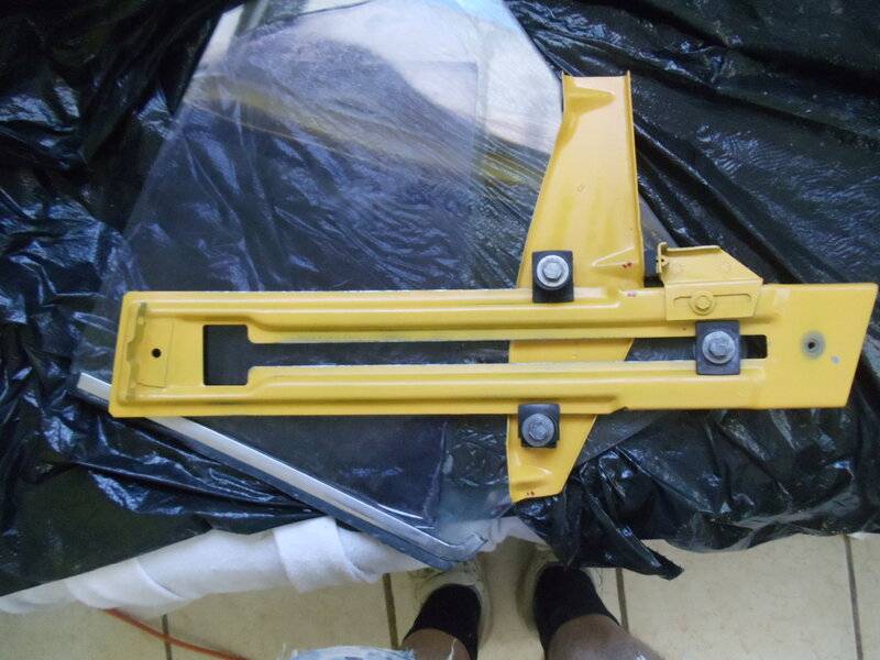

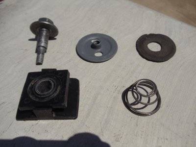

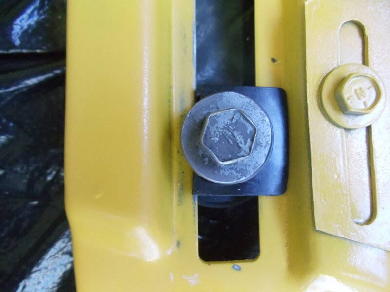

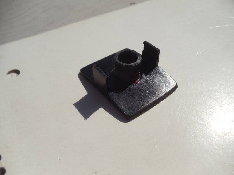

quarter window slides the black plastic piece
These photos are a 1972 model, which may vary somewhat from 1971.

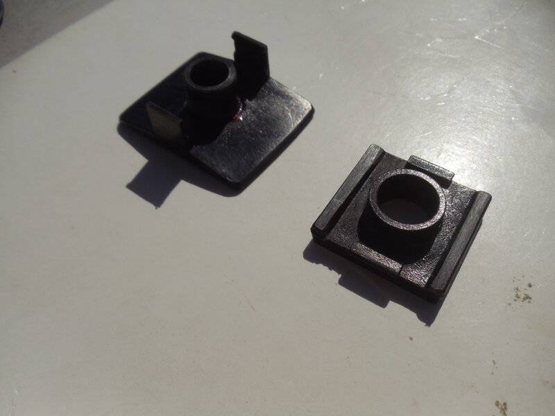

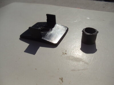

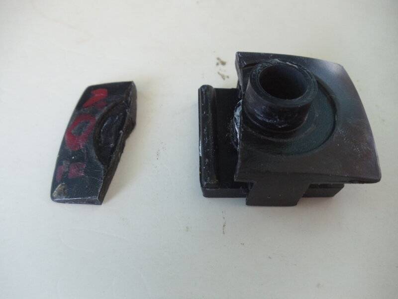

The plastic guides with the grooves sometimes have chips and other defects where the plastic breaks off. I re-used a couple of the "defective' guides as they were, and the window sill slides "OK". Please let us now if you find any replacement aftermarket ones.
I did glue one plastic "cylinder" back on (see photos #1 and #2). Another repair on a little broken plastic "tab" did not hold up.
