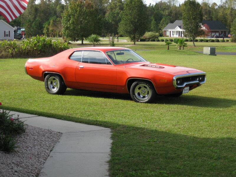

I have a 1971 Roadrunner and thinking about wider and bigger tires for the rear. Currently have 225/60R14 on all four. Any thoughts, recommendations or concerns?
Thanks
275-60-15 on a 15x8 with 4.5 backspace fills the wheel wells nicely.
there has been people posting that a 295/50/15 on a 15x10" w/5" BS works on the rear.
