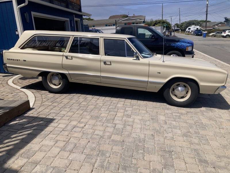

No help on pictures but tire choices for 14's are slowly going the way of the Dodo. 15's all around would be better for you. If you do a disc upgrade, assuming it's not been done already, 15's allow you to run the 11.75" rotors. I had 14's on the wagon, with 215/70's, when I bought it. Included in the buy was a set of 15x7 cop wheels. Got them blasted/coated with 235/70 on the front and 255/70 in back. I wanted to be able to run the bigger rotors and tire size for 15 is well populated with choices. Dropped some RPM too due to the 3+" difference in tire diameter.

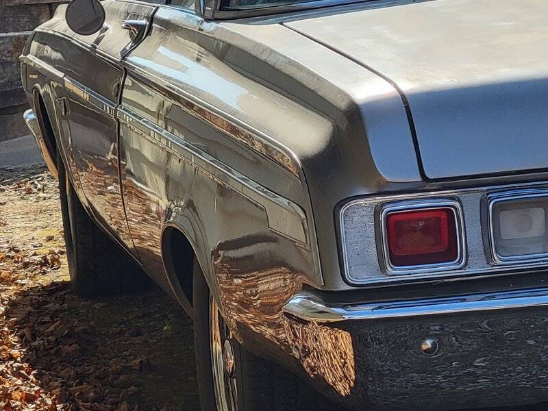

Somewhere I posted the tire size on my 64 but I'll be danged if I can find it. They look close to 255/15's and there is quite a bit of extra room. Springs moved in?
I sometimes run 255/70x15s on my 62, on 15x8 ramcharger rims. (NOT enough backspace.) Tight on the outside, plenty room to the springs/inner tubs.
I need to look mine over more closely. They look like standard offset Cragars. They may only be 6" wide. I need to try and measure. if they are 7" wide they would have 3 1/2" backspace.
Ah, I found the size.

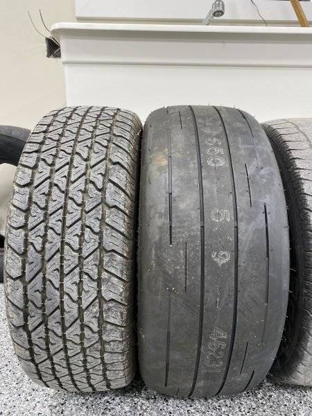

235/70/15 are 28" tall 9.3 wide
255/60/15 are 27"tall 10" wide

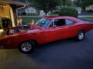

If you work real hard at it, you might be able to get 275s on it. That would require a 7 1/2” rim, and a minimum of 5” BS, and then wheel spacer to perfection. At least that is what it looks like on my 67 GTX.
Tire size and associated look are personal opinions. So there is no right answer as only your opinion matters. Myself, I prefer larger diameter tires, and try to match the diameter front to back.
This is on mine now. 255-60-15 on the back, 225-70-15 on the front.
