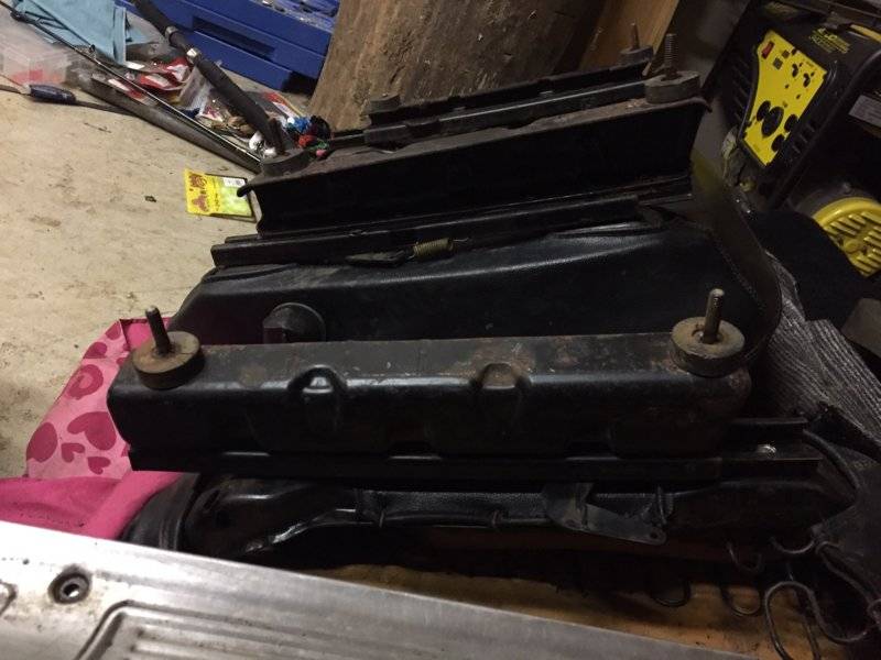

I am working on a 1971 roadrunner and needed to take the seats out. In the process several of the bolts sheared and the bolts appear to be welded. Does anyone have any advise for the getting new bolts into the old brackets or know where I can find replacement seat brackets (slides)? The distance between the bolts is 12.25".
Yes, if you have a nut/bolt/fastener place near you, they should have these. Even most Lowes or Home depot might.
They are called elevator bolts and they work perfectly. Drill out old, use these and you can even tack them in if you like.

Thanks as well. I drilled out the old ones today and wire brushed the rust and spray with rust converter. Gonna spray them black and get the new bolts and I'll be ready to reinstall the seats.
Thanks again to both of you for the guidance.
