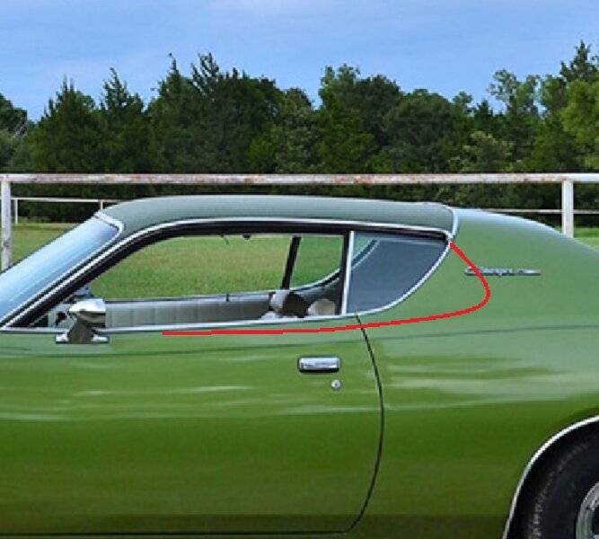

Striker is at same height, but belt line height ( top of door and quarter glass openings ) is higher on 71/72. 73/74 door definitelly won't close on a 71/72, maybe the other way around will, but definitelly won't meet shapes and lines on top half
something like this... on Red, the aprox 73/74 "belt line" shape over a 71/72 body. This makes top interior panels don't fit either
difference is around inch and a half or two
so you can figure out now also the diff inner sheet metal parts too.
Maybe lower half of door will meet with quarters, but definitelly not the top half.

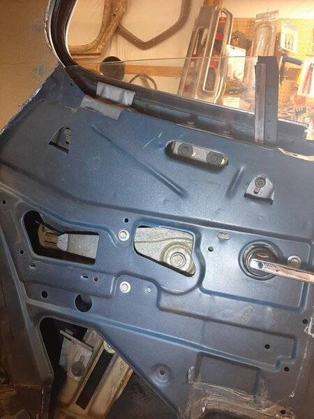

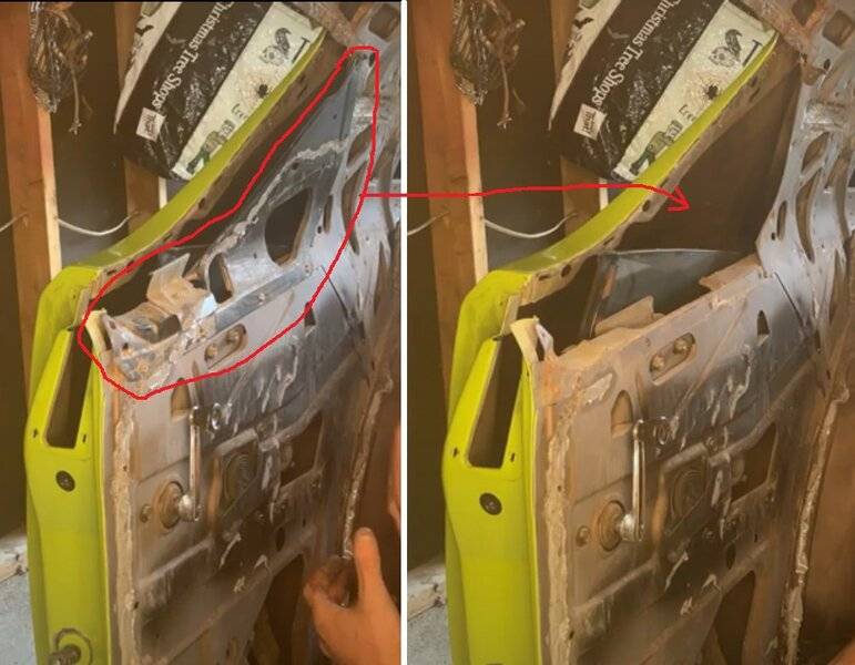

since 71/72 gets a filler for the upper interior panels fitments MAYBE the 71/72 inner quarter frame areas could fit/meet with the 73/74 areas? dunno. 71/72 Satellites got same quarter window shape. Not sure if the inner quarter frame areas are the same between 71/72 Plymouths and Chargers hence the reason for the extra filler panel attached into 71/72 Chargers. Just thinking out loud!!! But the jam panel for the striker is definitelly different and would need to get the 73/74 piece too.
compairing with 73/74
They seem to be pretty much the same! or with minor differences so it could be doable!
quarter extension areas would need also to be taken from the 73/74 to meet with quarter since that area is also diff between 71/72 and 73/74

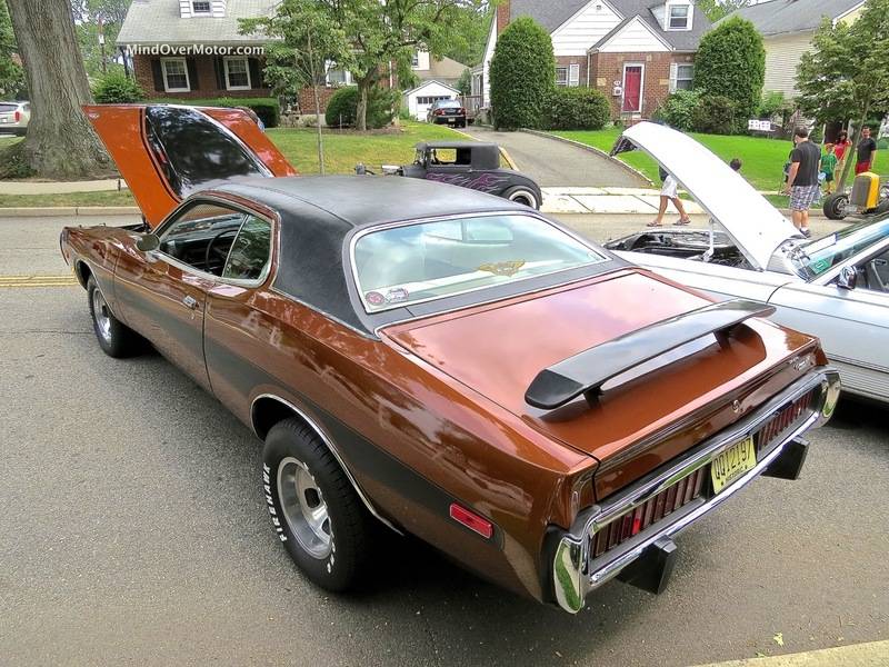

quarter extensions are different as well? We are talking about those little nubs on either side of the trunk, right? Dang I thought those were the same part 71-74. this thread is getting crazy
Check how the upper body line changes between 71/72 and 73/74
74e4251904ffd31a7a5d7f618f2a5b410d7cbe94.1971-dodge-charger-se-383_rear_FULL_paledog.jpg
73/74 with a small lift up at the end and sharpier, while 71/72 keeps the same line coming down and ends a bit blurry.
This makes not just the quarter extension but the inner piece where attaches also diff. To match the diff quarter shape there
