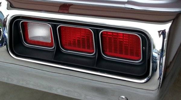

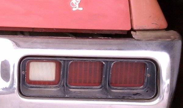

I don't have experience with them, but, I was thinking if your lenses are not cracked or chipped or pitted, why not just clean and polish them? I did that on my 73 lenses they just were coated with a layer of crud and yellowed and I polished them by hand with some rubbing compound then a nice wax to buff them up to a nice shine and they came out real nice.
Before
After
If you notice after I polished them, you can now see the reflections on the inside of the housing versus the cloudy state they were in before.
