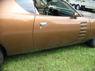

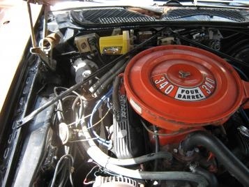

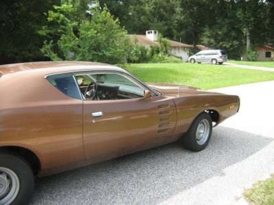

Cars info ! 1972 rallye charger 340 magnum automatic 8 3/4 sure grip stock 2.7? Gear .bucket seat car was gold exterior.white/black interior. Solid mount head lights . It was an interesting car but all I was wanting was a 72 rallye with the 340 magnum everything else wasn't important.

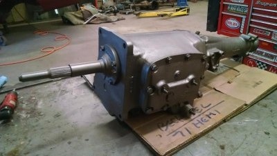

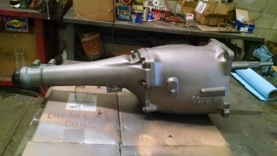

Remove automatic upgrade to a 4 speed (I'm old school)

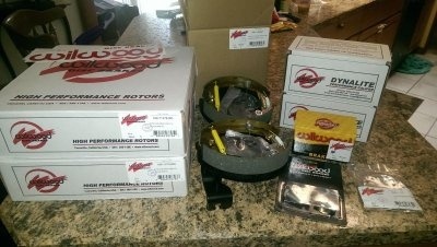

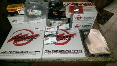

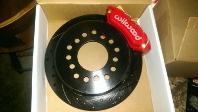

4 wheel disc brake conversion

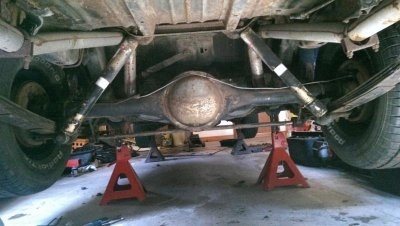

Diff ,it got upgraded right before I bought it to a 8 3/4 sure grip with 3.55 gears but it's still a 741 case .womp woomp! I am ether going to
1: leave it to save on cost ,
2: try to find a 742 or 489 chunk and put 3.55 or 3.91 sure grip in them
4: dana! With above gears
Dana is deff overkill but it's a charger it should have a Dana right?

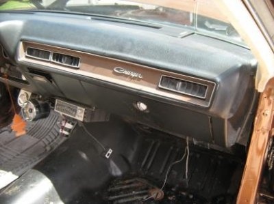

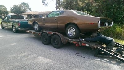

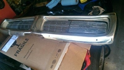

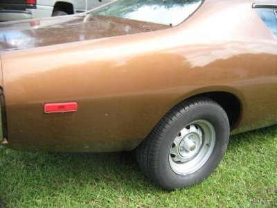

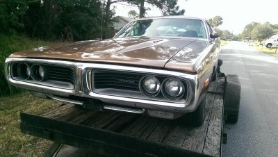

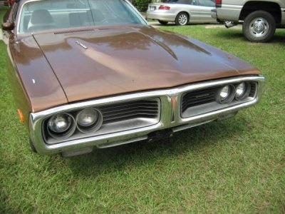

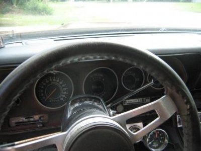

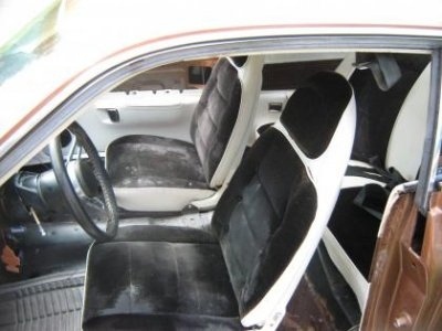

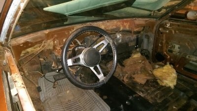

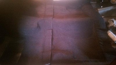

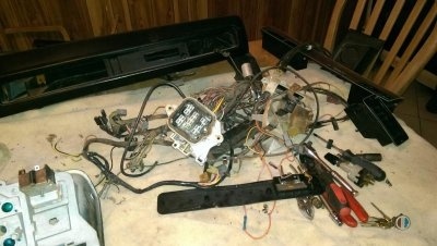

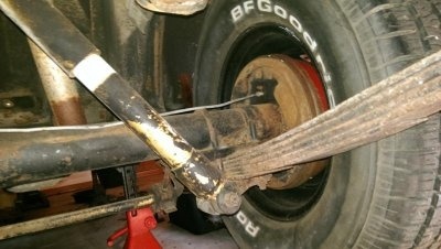

Here's two pictures of when I bought it and a picture of my last build that I'm going to copy basically as I liked how it was going wish I finished it . But now I can do it with a 72 rallye with a bad *** motor and a bit more bank to back the build up. Enjoy !
By the way please reply with input it gives me motivation! I need it badly!

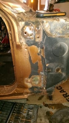

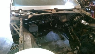

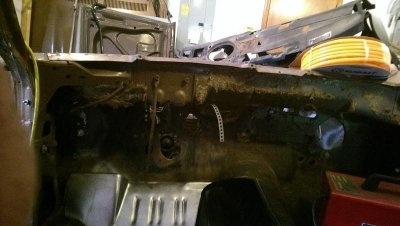

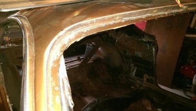

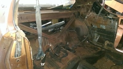

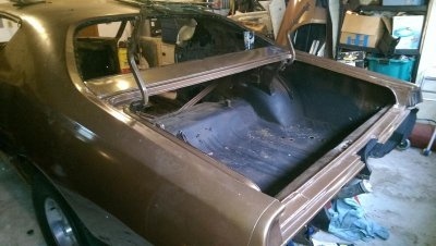

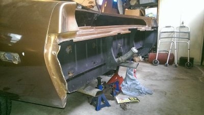

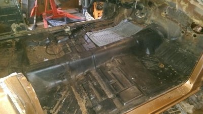

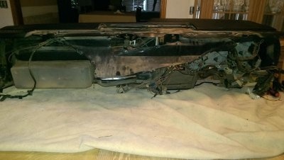

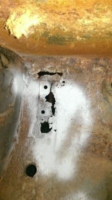

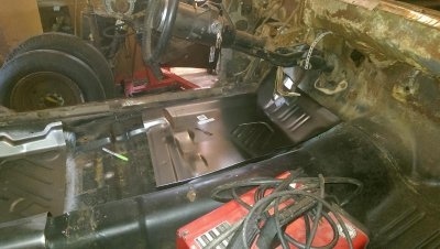

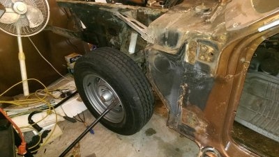

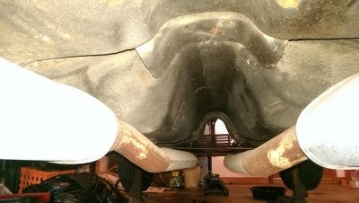

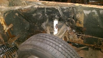

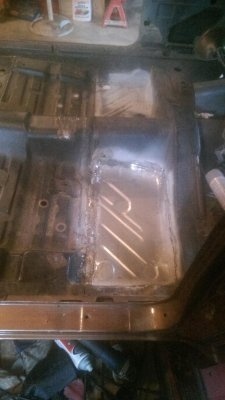

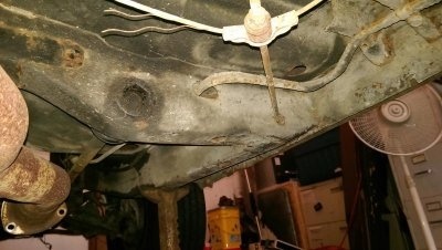

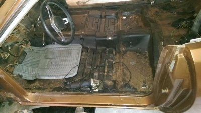

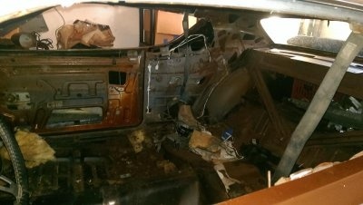

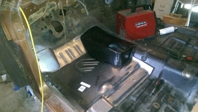

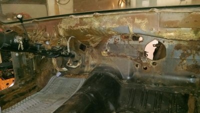

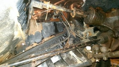

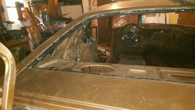

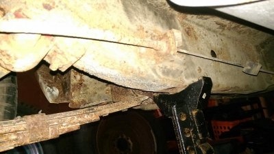

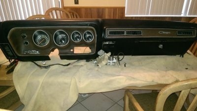

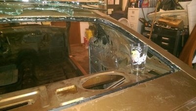

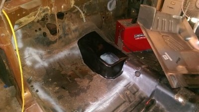

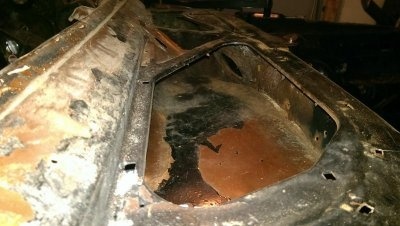

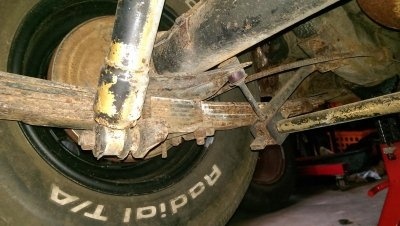

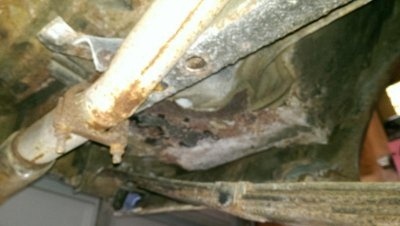

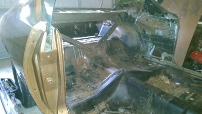

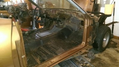

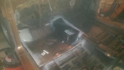

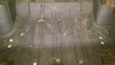

OK so yeah got it ripped it apart to check for damage. Ordered parts and kinda left it alone past that
and this is about current . I'm getting the car pulled around front into garage,so I can finish ripping it apart and get it up on the rotisserie to strip it. So stay tuned updates should be soon in the next few days. As I have a few other pending jobs that need attention first. Then full boar on the rallye .

Are you going with an overdrive unit like a gearvendors? Also you may want to upgrade the 741 if you have 450-500 hp.

The 340 is actually pre worked I have a list on it I'll get it posted it dinoed 435 to the wheels as it sits I am going to switch out a few parts add a bigger cam since we're going 4 speed !
Issues with the 741? The pinion is the smallest of the 3 but have you seen one fail? Only asking because I have one behind my 440 build
Yea, I broke my 741 3:55 behind my low deck Big Block. One burnout too many. It was in there for like 4 years before it broke. Tires might relieve some of that stress. I was using Mickey T's ET streets.
