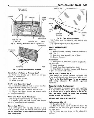

Here is a page from the factory manual that will help you visualize how many screws hold down the glass...(should be 4 I believe)
Once everything is exposed, go ahead and squirt those four screws with penetrating oil and once again pray that they aren't rusted to bad. Holding those screws to the glass are these discs with oval slots that are meant for a specific tool to hold them in place while the screws are backed out. I eventually remembered that at one time I'd bought a tool at harbor freight for removing my grinder wheel retainer....I got it out and it worked fantastic for these window retainers. It's an adjustable pin wrench and sells for $5 at harbor freight, item #36554

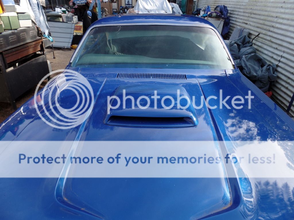

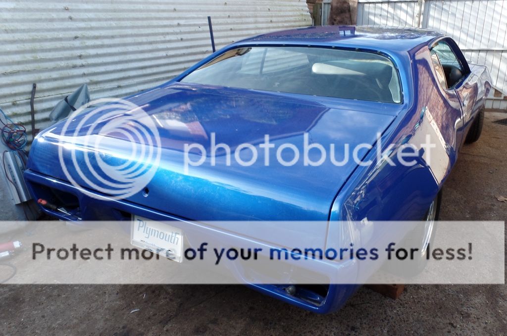

I have cleaned off the silastic & some surface rust & painted the nuts blue to match the car.. :happy5:
Had the new windscreen fitted last week
Had the new rear screen fitted as well
Hoping to get him finished very soon..
