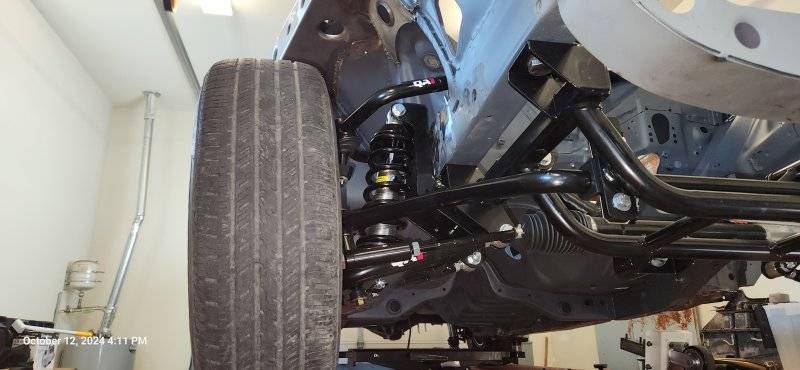

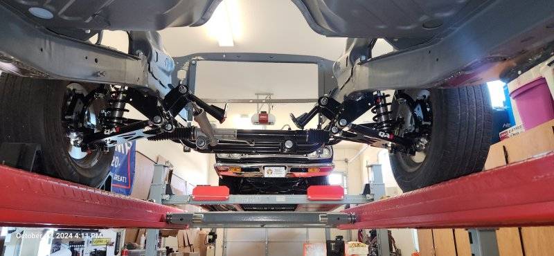

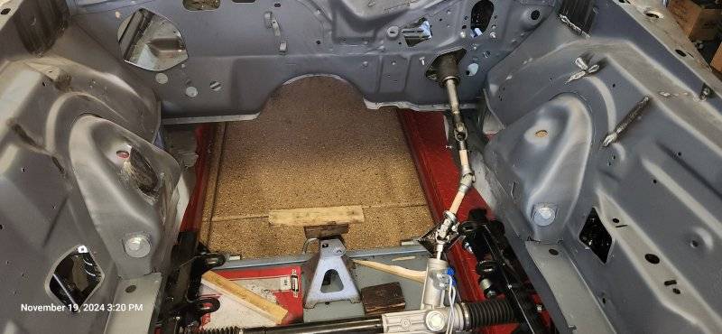

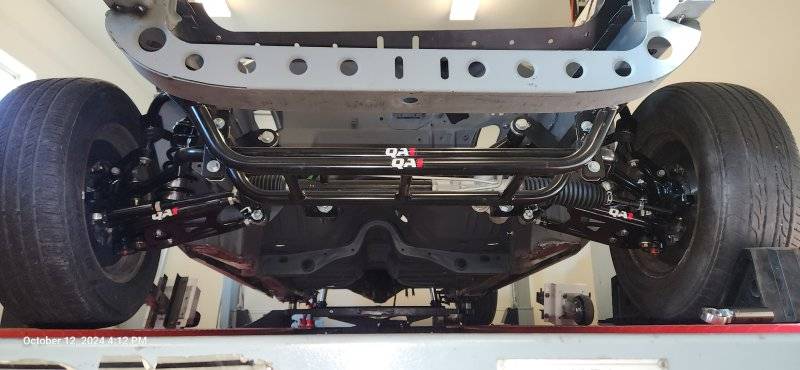

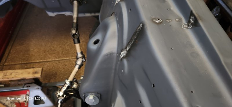

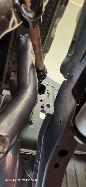

Time for more pictures. The frame stiffenening kit is done, all welded in. I started on the new suspension. QA1 front and rear. Double adjustable coil overs, tubular k frame, 4 link in the back. The front is pretty much mocked in where it needs to be. I need to take the springs off the coil overs to get the chassis down at ride height with no engine in the car. Need the front end down at ride height to get the 4 link set up in the back at least close to where it will be. Nose high effects that. The hardest part of installing the front kit was cutting off the factory bump stop brackets.

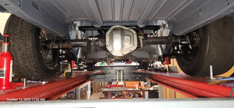

The rear kit has a main support bar that gets welded in between the frame rails. Coil overs and upper control arms mount to it. It is holding all weight. The frame rails in this 72 taper outward toward the front. The rear of the bracket wedged in between the rails nice and tight for plug welding, but the front of the bracket had a 1/2" gap tapered away from the rail. Had to bend a dog leg in to the front mounting of the bracket to get it close enough to the frame to plug weld. The factory shock mount bracket has to be cut off yet.
The rear axle is mocked up. Cant weld the perches and the upper control arm tabs till the trans is in and pinion angle can be set.
Putting the rear Wilwood brakes on the Dana axle has issues. Wilwood requires Green bearings which the axles have on them. But, they must be a very old version. The brake rotor/axle needs to go in another 1/4" for the caliper to mount correctly. Going to get some new Green bearings and see if that solves the problem.
