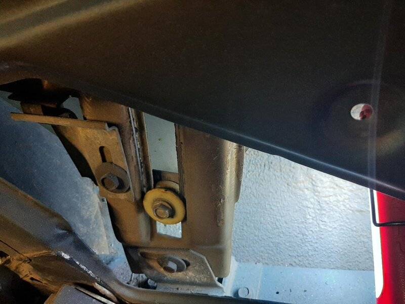

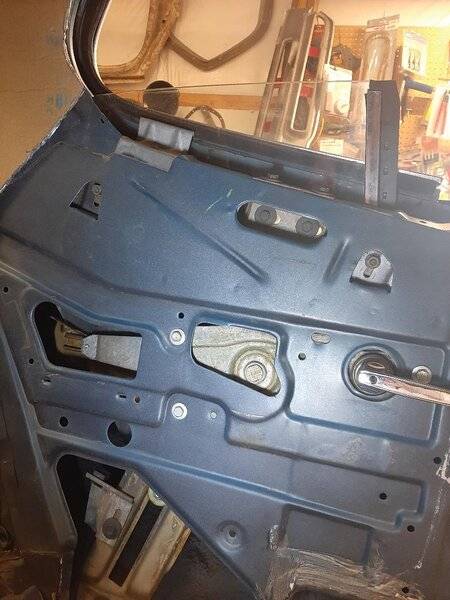

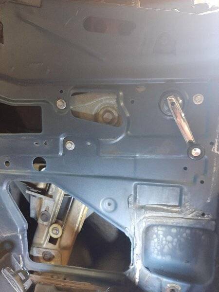

My rear interior panels are out of the car right now and the rear quarter windows and regulators are installed. What specifically would you like photos of?
Here's what I have right now. These are photos are driver side rear quarter window mechanism.

Here is a 71 dissasemble process for reference a buddy recently uploaded ( same than 72, but the glass itself and how attaches to the regulator )
There it mentions the track on body. I can't remember that one on my 74. But I think it gets a removable rail on a similar location? Damn! I can't recall right now
Taking the top two 7/16 nuts and bottom bolt out and disconnecting the arm is ABSOLUTELY the way to go! Thanks for posting video!
OLD post but I bet @moparmarks would know. I believe the regulators are different from 71-2 to 73-4?
On doors, 71/72 vs 73/74 the only difference between regulators is actually how they slide into the channels. First ones are square sliders while laters are rolers, but they perfectly interchange.
now, dunno about rears really. Even less between Chargers and Plymouths
