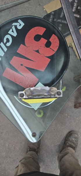

I have a 73 roadrunner with fixed rear windows could not find new glass all they had was for rollup window I orderd them anyway if u narrowthe bracket and make it shorter they fit
I can’t find the rear qtr glass either. Do you have pictures of how you did this?

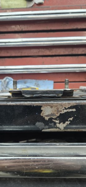

this is modified bracket to make roll up window work
That pic is with bracket installed if u get new windows and see them side by side it will make sense you have to narrow bracket to fit holes in glass and then shorte bracket because holes are higher up in New glass
