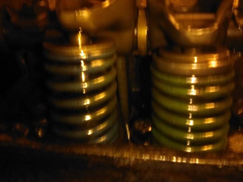

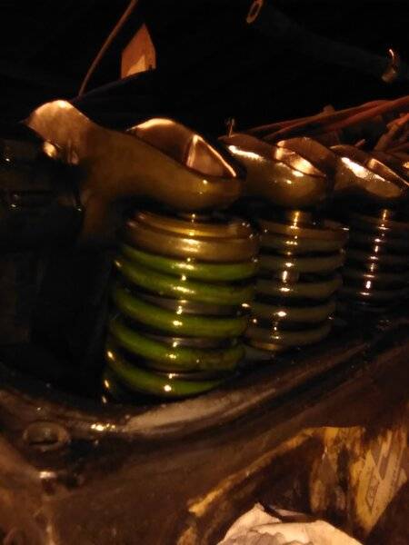

Ok so both heads currently have what look to be regular spark plugs, with out the washer.
Currently in it are AC R43TS plugs.
Both heads have blue valve springs, with an inner damper spring located on all exhaust valves.
the 213 head has a 0653, or 0633, very hard to tell, the 346 head has 0063 cast next to the runner.

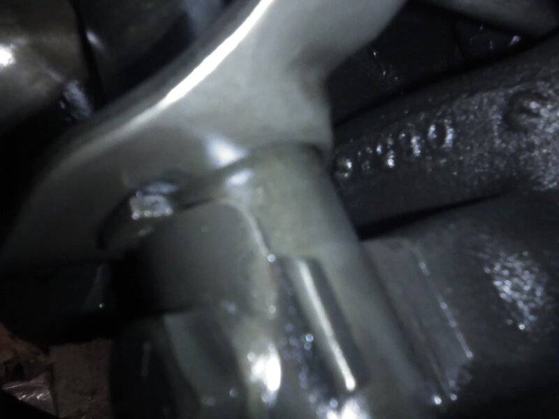

I will post some photos of the way the plugs enter the head,here is the casting date on driver head 213, and valve springs.

So from what a few sites say casting date on heads are first 3 numbers are for the day it was cast, last number is for the year.
So for the motorhome head #213 cast on 63rd day of 1973, and the #346 head on the 6th day of 1973.
The engine block was cast on 2-27-73.
