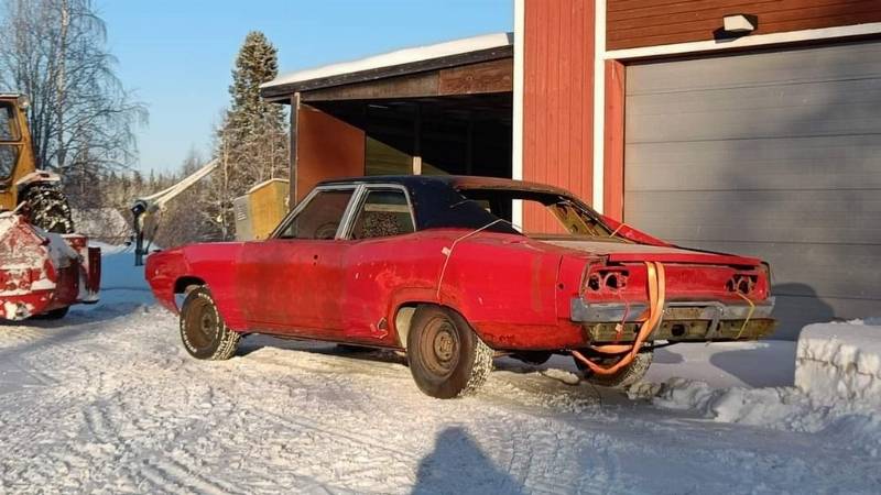

Well, those two are actually Coronets with Chargers parts adds on. So no real structural mods like moving/installing pillars or door frames.
Yep. Front clip is bolt on, but does not line to doors. White seems to have modified front doors with Charger skins. And rear end is stock Coronet. I'll use Charger quarter panels, tail panel and trunk lid. Rear window area has to be made fit Coronet roof and Charger panels. We'll see how it goes...

This one has b-pillar moved about 8" and front doors are lenghtened

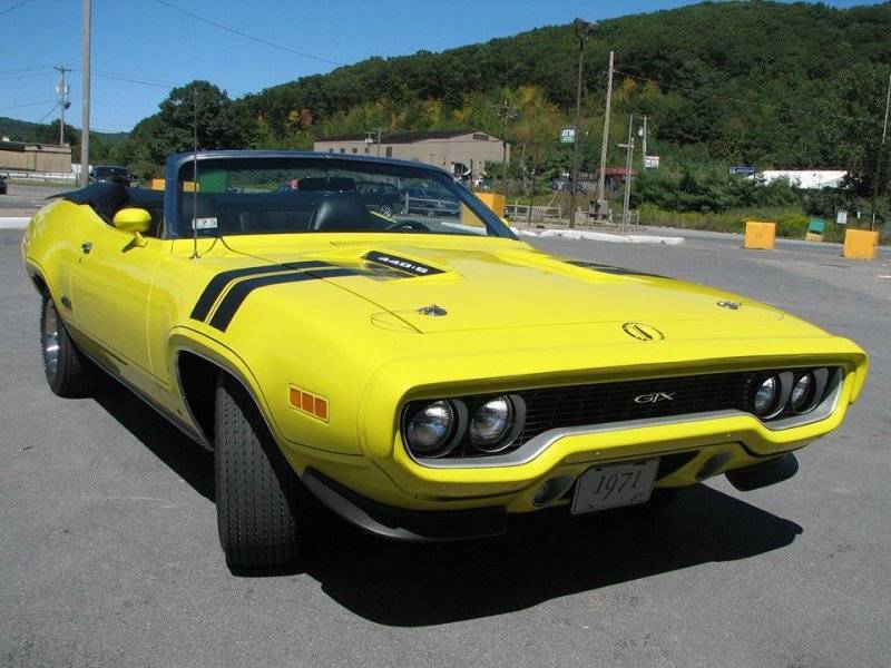

This is the 71 GTX convertible my friend did. He had a foundry make two of each side rear quarter windows. A pair to put in the car,and a pair of spares to have replacements if one got broken.
