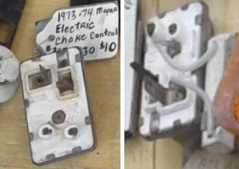

I have two of these choke controls (used). See pic below. The one on the right has part #3656730 on it. I don't have the part number for the one on the left but I can get it. These pics are from one of my swap meets and not very detailed. Again these are used and working condition unknown, I would refund your money if you got stuck with a bad unit if we were to come to a deal.
The one on the right with the resistor is # 3755770 - 74 and up and not correct for 73.
The correct # I just looked up again is 3656730. They are all over Google to confirm and honestly the only thing you can do is check continuity between the terminals. However I honestly don't remember which is which.

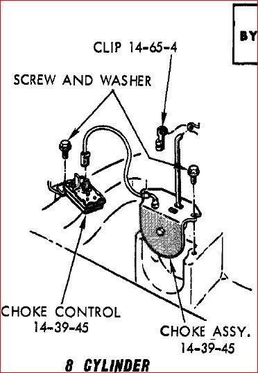

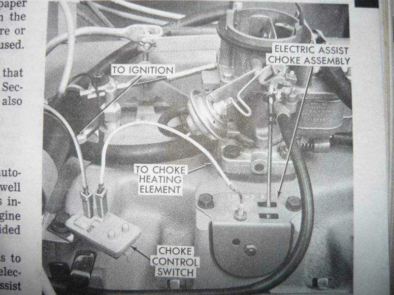

Possibly this will help.
