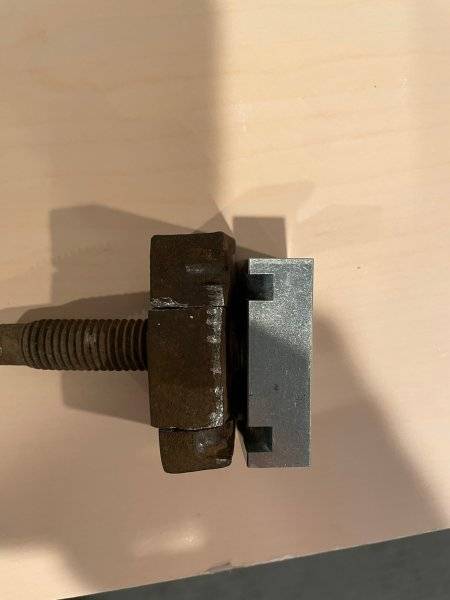

I have a 1973 Plymouth RR that had the the torsion bar adjuster nut snapped off before i bought it. I unloaded the suspension and cut it free. The replacement item i bought from year one does not fit. i bought
Part Number: 52360 QA1 torsion bar adjusters for 1962-74 Mopar models.
Can some one tell me the part number that i need? The new one is to narrow by about 1/8th of an inch.

Another case of a company selling parts that aren't right for a 1973 B body. PST, who is a sponsor here, is the only company that has the correct size. Their's fit 73-79 B body. I bought them for my 74 Charger and they fit.
Part # TORADJ-C
Specs Bolt - 9/16" bolt with 3/4" head with overall length of 3 5/8" (excludes head) Block - 2 1/4" long, 1 1/4" wide, 3/4" thick with 1 1/8" hole on center
Look them up in the vendor section. They offer 10% off if you spend over $200.
What many don't realize is the hard line between 72 and 73 suspensions. 73 and up were rubber iso syle and are different than the earlier style. PST is good, as is Firm Feel, but be careful of anyone who says these cars use the same suspension parts as the earlier ones.

thank you very much!
Mark
thank you. This is very helpful

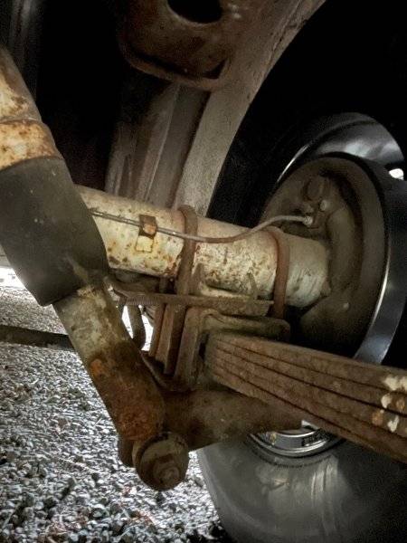

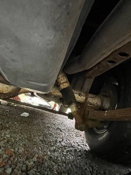

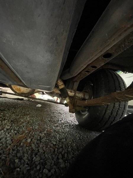

i also just realized that the ubolts that i ordered from the same company are wrong as well!
do you have the correct ones for a 1973 Plymouth road runner b body?
I searched everywhere and couldn't find correct 8" Ubolts for my 74. You can get the correct length at Mancini Racing or ESPO (Springs 'n Things) but they won't have the flattened top with the crosshatch. What length did you get? I'm curious if the 7 1/8" Ubolts would work. What axle housing do you have?
