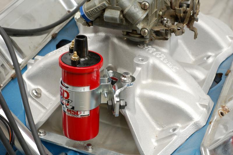

Here's a neat coil bracket that AR engineering makes. Go to their website to see it .......arengineering.com

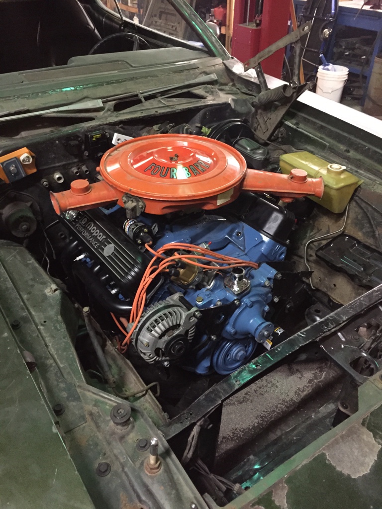

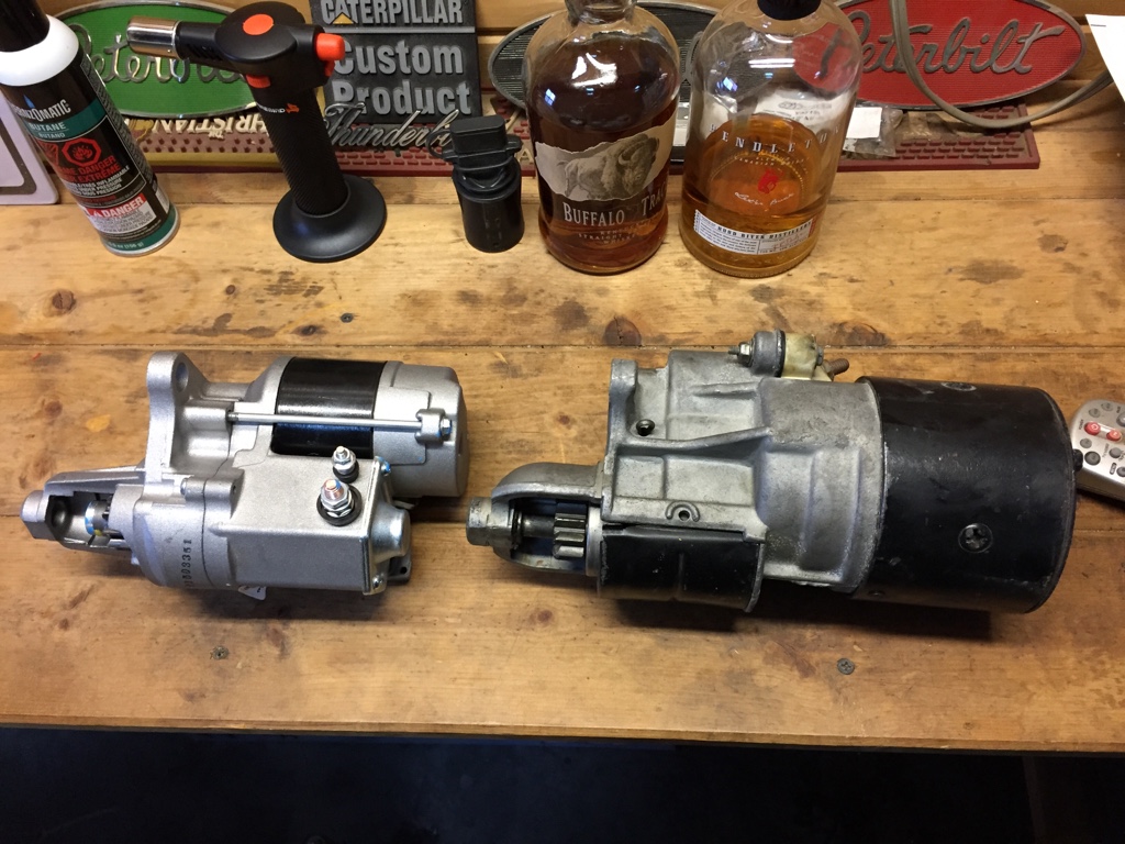

Sent the radiator off, and mounted the headers with a little massaging. Im going to have to find a mini starter to fit with the headers unless someone knows how to make a full size starter fit with Hedman headers
Lots of folks here use the 94 Dodge Dakota starters, I am using one on mine with TTI headers. I am using the Ultima Select part number 33355 from Oreilly, I believe it fits both big and small block, but don't quote me on that.
Thanks! I'll have to check that out tomorrow. I wasn't looking forward to ordering a mini starter.

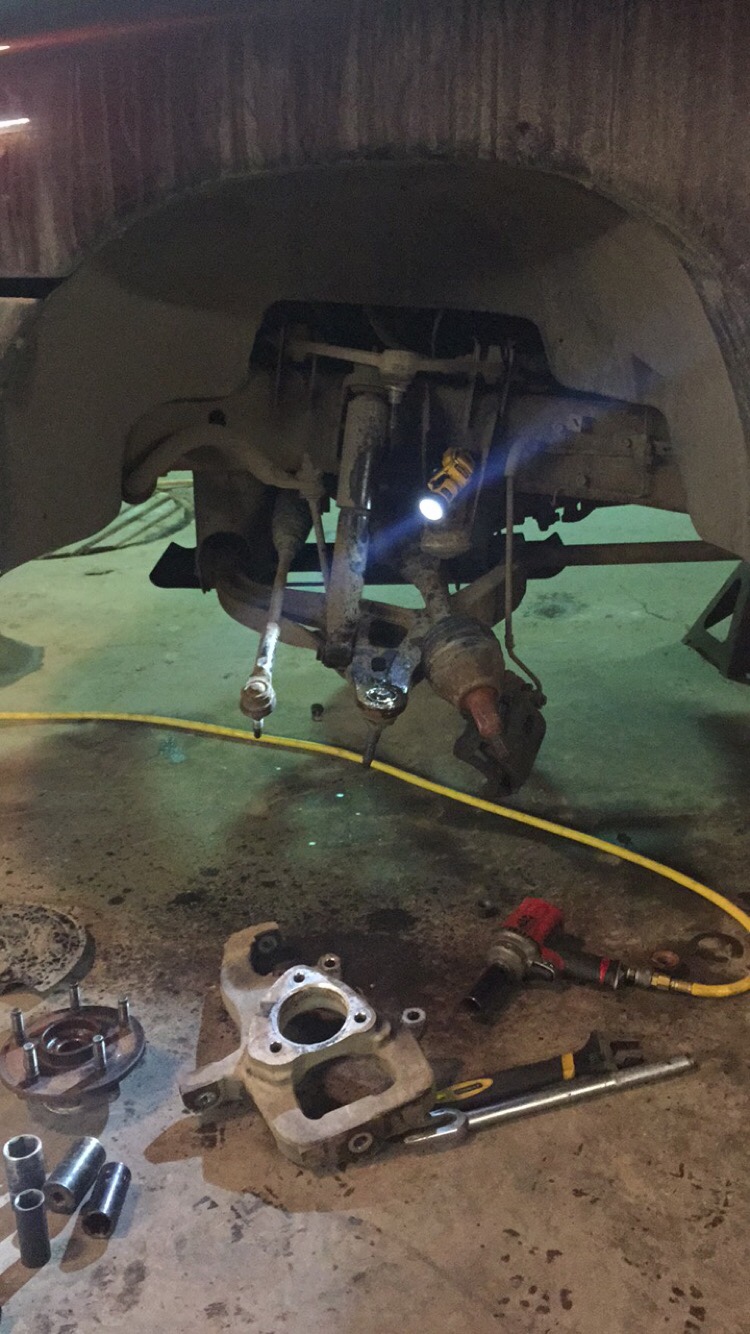

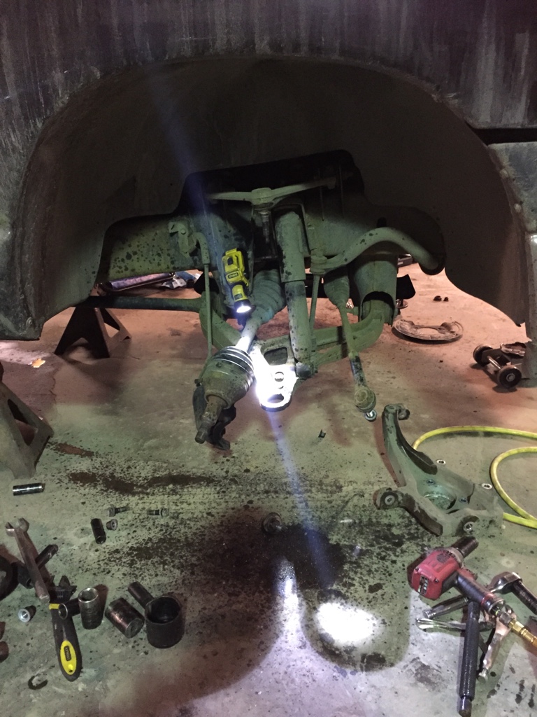

I picked up my Dakota starter today and that's as far as I got. Spent the rest of the night putting ball joints in a 2004 Dodge Ram 1500 4x4

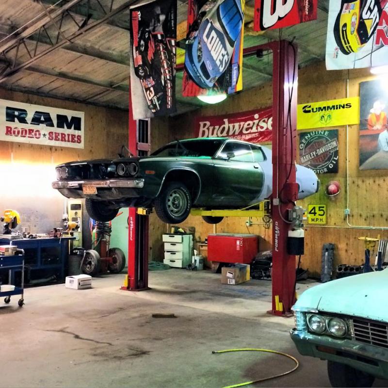

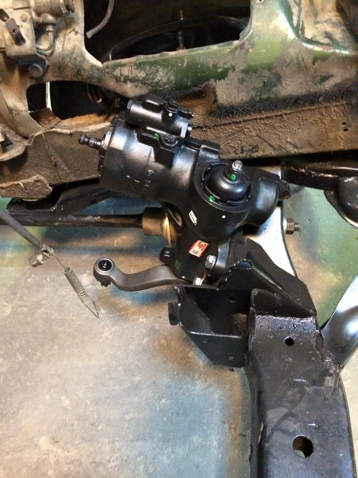

Not much to update again. I finally got a new steering box in the car, and I also had her up on the lift to put some brake calipers on the front, and finish the rest of the steering (tie rods and stuff). I had to swipe some brand new tires I had up on the rack to swap onto the front. The old BF Goodrich silvertowns wouldn't hold air anymore, and it's kind of hard to move a project car around without tires. Too bad they are only 225/50r14s because they are brand spankin new.

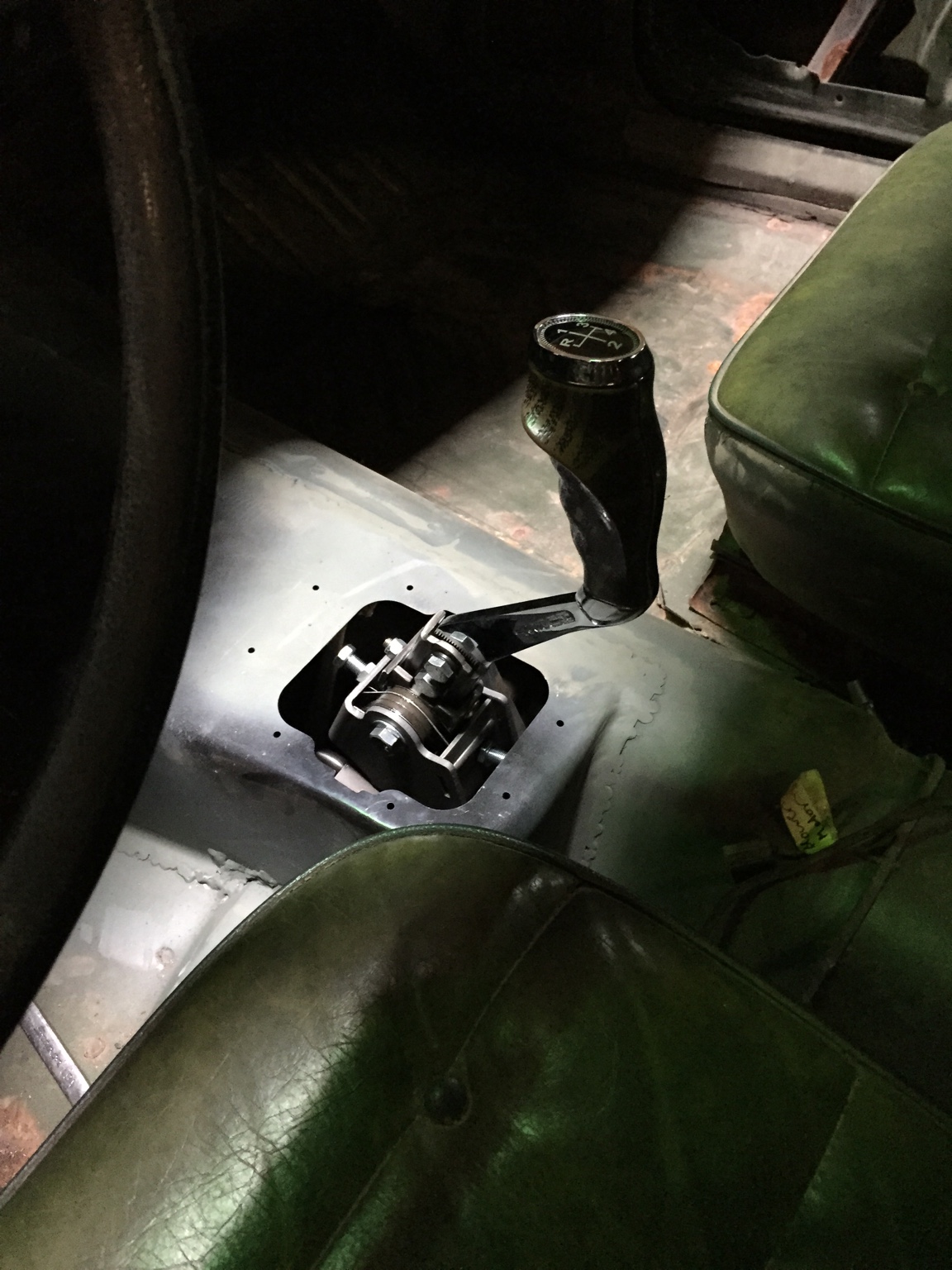

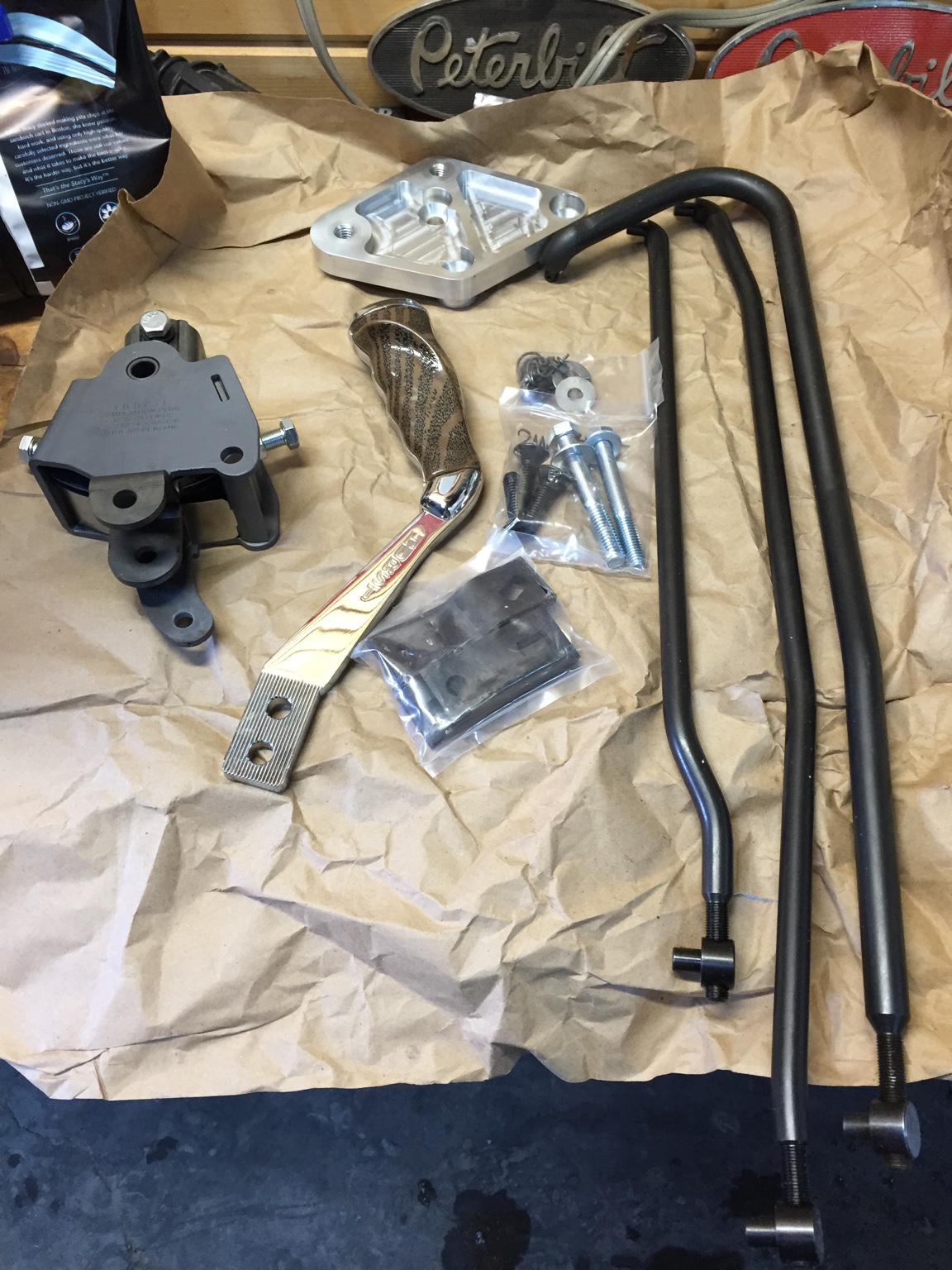

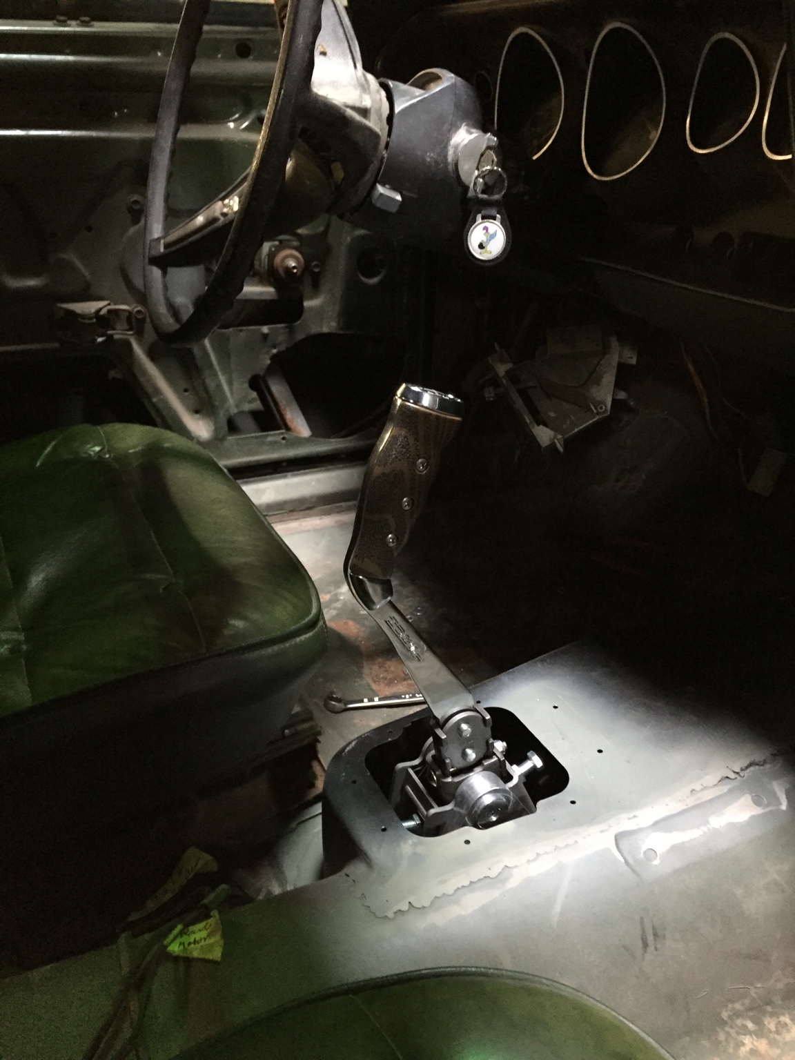

Well the shifter is mounted in the car and all hooked up. Still waiting on my radiator and driveshaft. I also have new pulleys and belts coming from 440 source and some other parts from yearone that I am waiting for.
