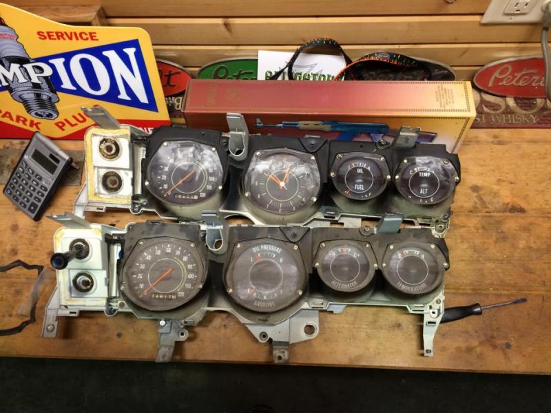

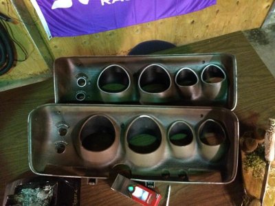

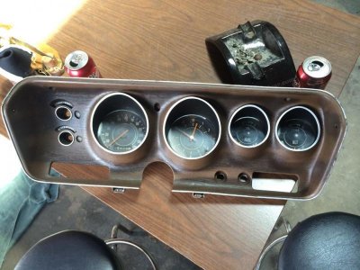

Bought a different gauge cluster off of ebay. It's in better shape than mine and has the clock. Someday I would like to put a tach in it.
New one on top and the old one out of the car on the bottom.
New bezel on top
Good score. Silver leafing paint pen will fix up the bezel edging real nice! And a fluorescent orange pen for the gauge needles works great also.

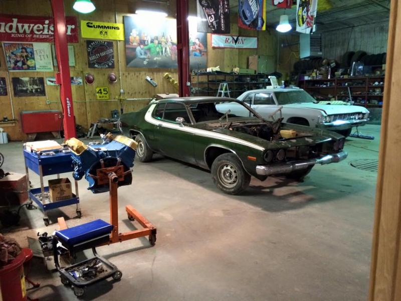

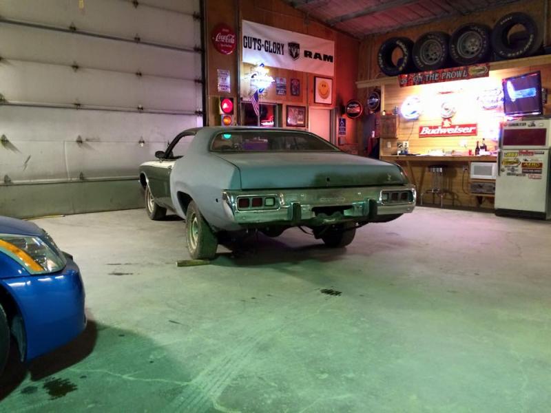

Also, I finally got the car up on 4 wheels last night and moved it out of the back corner of the shop. Now it'll be easier to work on with the lift.

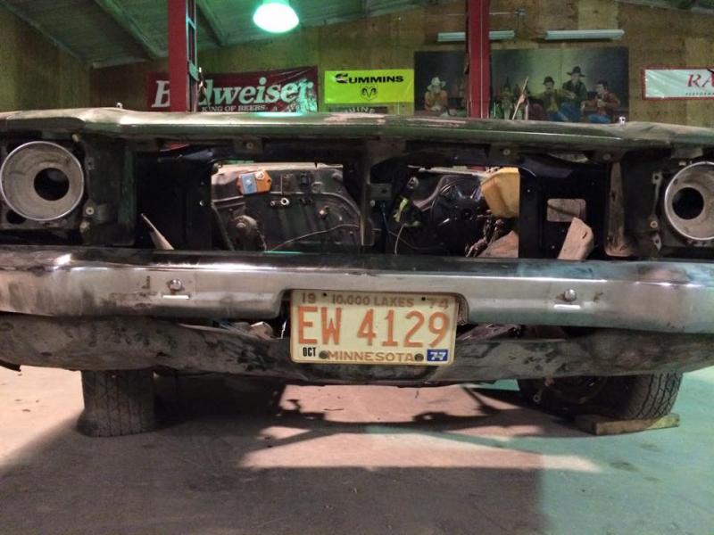

Just a small amount of progress lately. Finished getting the rest of the bolts in the fenders and put my old beat up front valance back on until I can find a better one. Too bad these license plates are a year off. I believe in MN they have to be the same year as the model year of the car. Shame because I have 3 really nice sets of 1974 MN plates.

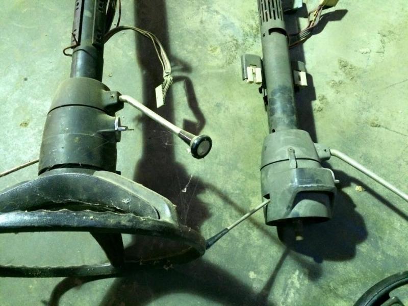

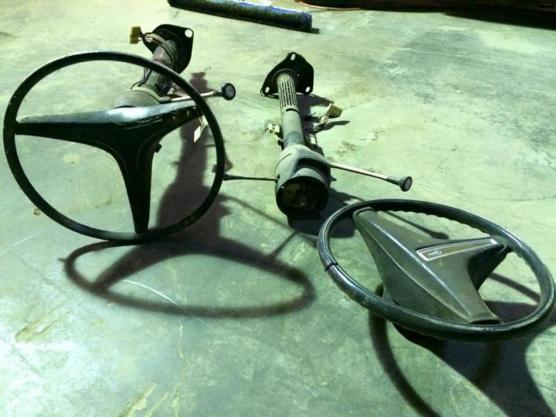

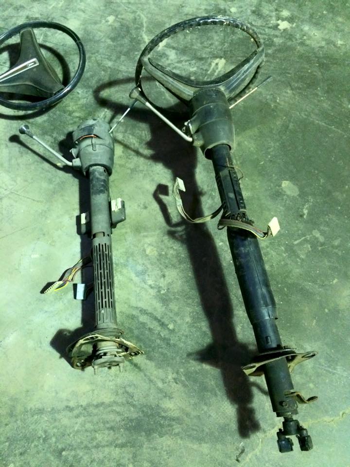

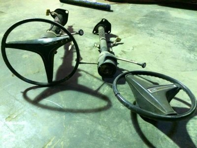

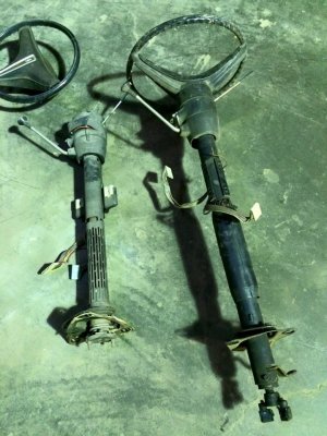

Also, wondering if the steering column on the right will work in the car or what it is out of. The one on the left is the one that was in the car but does not have a key. The other steering column has an ignition key.
The one on the right is not for a Roadrunner/Satellite. The one on the right is ok for column shift, but it doesn't have the gear indicator section, which would mean its from a car that has the gear selector on the dash instead of the column, fury, imperial, valiant, etc. The one on the left looks right, just take the key assembly out and get it rekeyed or install a new one.
Thank you! I'm just going to put the column shift in to get it driving. I'll change it out when I find a different column. Can I take the ignition out of the column on the right and put it in the column for my car?
Hey Dieselholic, if the ignition mechanisms are the same size(diameter), I don't see why you couldn't just swap them.

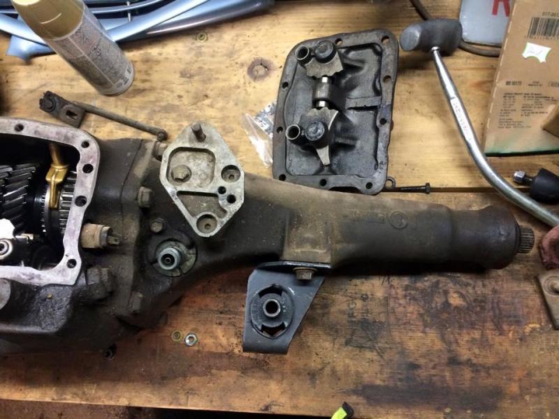

Here's the tail housing on the A833 that was in the car when I bought it.

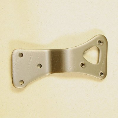

If I use this transmission, is this the mount I need for the shifter?
It almost seems like it wouldn't move the shifter far enough back if I put the full AMD 4 speed hump in it. I guess I could always cut the hump and move it forward some.
I did pretty mutch the same , here are some pics click here ------> scrole down http://www.forbbodiesonly.com/moparforum/showthread.php?27567-Need-1971-4-speed-linkage-help
http://www.brewersperformance.com/4speed.asp these guys are great to work with and have high quality parts for four speeds and swaps
That helps a lot! Thank you! So It looks like you didn't have to shorten your 4 speed hump at all. I've looked at brewers and I'm definitely getting my rebuild kit from them when the time comes.
