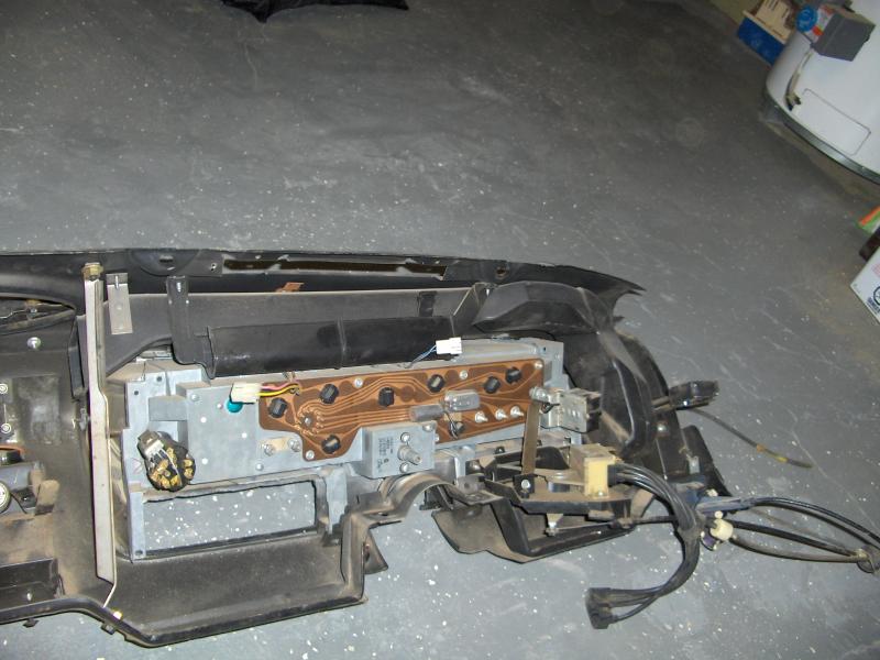

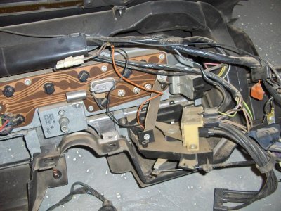

He is wrong,my 74Satellite Sundance standard dash has a 3spd switch and I put it into my rally cluster but if I remember corectly I had to also swap over the heater/a/c control to make it work because the two interfered with each other.I just remembered that the non rally head light switch was way to long and I had to reuse the one from the rally.
I did some digging and found a few pic's from when I swapped my standard dash over to a rally.On the left of the pic you can see the 3spd wiper switch.

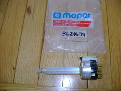

Here this might help......
NOS 72-4 SATELLITE,CHARGER 3SPD WIPER SWITCH W/O RALLY

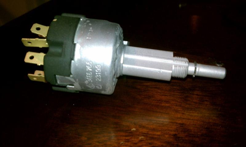

71 72 73 74 roadrunner gtx charger 3 speed WIPER SWITCH cuda challenger e b body
Hey 74Sundance, thanks for the reply and great pics. I knew he was wrong but needed to have more expertise from people on this forum
who have done this before.
