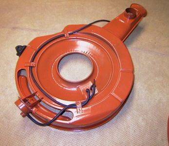

So I'm curious if someone can shed some light on the subject.
NICKS GARAGE site has a long list of air cleaners... I'm curious about this one in particular...
1974 360 4-Barrel for B-bodies. Has flap in floor that opens at full throttle to allow more air in.
How many different ones were available for the 74 360? Is this the one that is supposed to be on my 360 "L" code? Did some come with the flap door cleaner and some without?

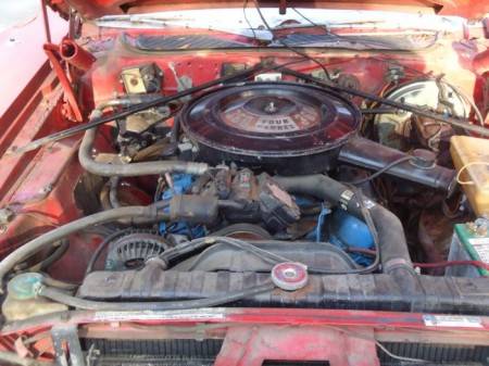

I ask because mine currently has what looks to be the
1975-76 360 A and B-Body. No flap in bottom
What is the likelyhood that the 75-76 one is correct? Car build date was June 74...
Any light on this situation?
Thanks.

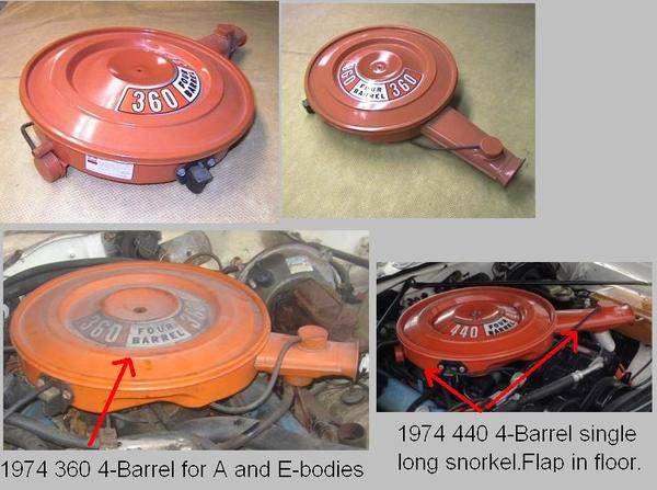

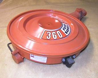

72 340 had the same flap deal. Maybe that's what you have.

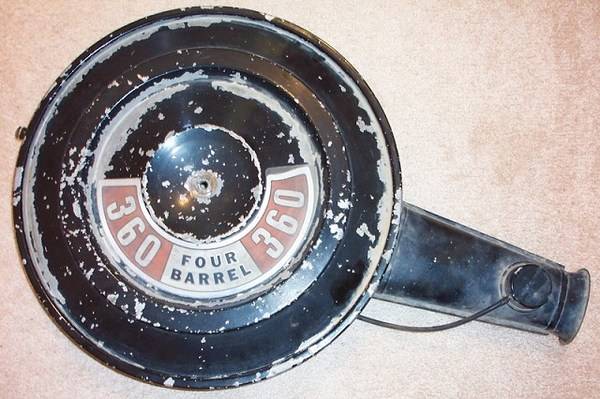

I think you have an A or E-body air cleaner there. I have several later B bodies (two 74's and a 75) and they all have the black air cleaner shown in your photos.
I have seen the orange air cleaner on 74 360 E-bodies and A-bodies.
While this air cleaner looks similar to the 72-style with the trap door, it has an oval snorkel whereas the 72 air cleaner has a rectangular snorkel.
Hope this helps.

One thing to notice, is the orange air cleaner you have pictured has the OSAC Valve on the air cleaner. Does your car have OSAC on the fire wall? If yes, then the orange air cleaner is not correct for your car and likely the black one is the one for your car.

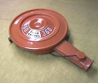

So you don't think a black version of that air cleaner would have made it's way onto the 360 bbody?
I haveseveral later B bodies (two 74's and a 75) and they allhave the black air cleaner shown in your photos.
Are your 74/75 the 360's? Didn't have a trap door?

Would be nice to know if there was a black 360 cleaner with flap door in general. All I've seen are orange.

I've never seen a black B body air cleaner with the trapdoor.
I have an L code '74 Road Runner a '74 L code Charger Rallye and a '75 L code Daytona Charger. All have the black B body type air cleaner without trapdoor. The '74 Charger and Road Runner are St. Louis cars and the '75 Charger is a Windsor car. The Road Runner is a 11/12/73 build date. The Rallye is a 01/11/74 build date and the Daytona is a 5/1/75 build date. Could there have been a few orange 73 style air cleaners in 74? Sure, the factories used whatever was on-hand. My Rallye is untouched and has a '73 hood on it. Mid year build date too. Go figure.

Then Im gonna say that this Orange 74 360 oval long nose snorkel with trap door doesnt exist.
Its probably a hybrid mix between a top/cover from a 74 360 A/E body and the base from a 74 440...
Put those 2 together and theres the supposed Orange 74 360 oval long nose snorkel with trap door
