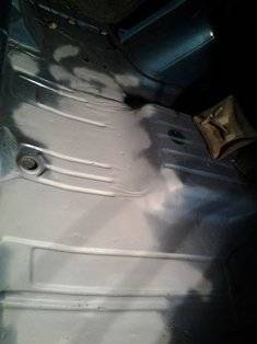

When you say a non-expansion top, does that mean the top of the tank is flat rather than have the bulge like your stock 74 tank has? Just remember your trunk floor and braces have the bulge for the expansion gas tank in the bottom side of the trunk floor. A flat top gas tank like the 71-73 gas tanks will not fit right under the trunk floor because of the bulge. You may have to put something on top of the non stock tank so it doesn't move around. Just a thought. See the trunk for photo for the trunk floor bulge I'm talking about which is what yours should look like.

OK. So it might move around a little bit then.
The guy says it's in a survivor and is the original tank for the 74 he's pulling it from. He understands the bulges and says this will work but does not have the expansion tank.
And he says it's a single exhaust tank.

I have a tank out of a 74 charger se, but it's been dented bad on the underside, but ya, you will want to stay with the odd shaped 74 tank with the bump in it
All 71 to 74 tanks have the same basic dimensions except for that 74 only top bulge.
