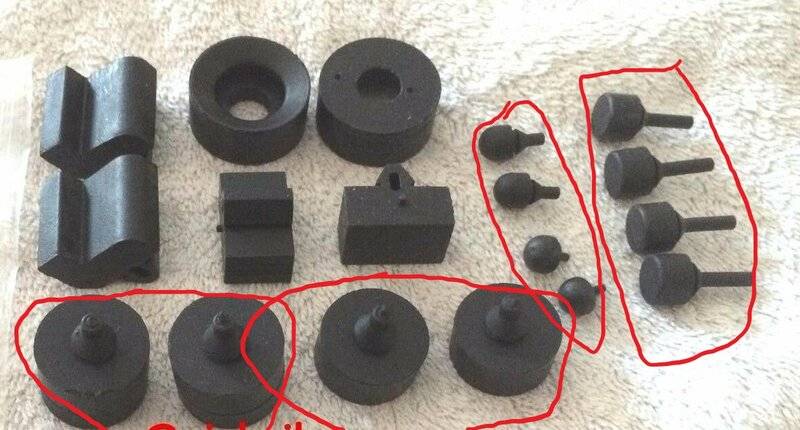

I bought this car as a basket case and didn't have any of the rubber bumpers. I purchased a kit but asking the seller and trying to find pictures and videos online has proven to be ineffective. I have circled the bumpers I have left. If anyone knows where they go I would be extremely grateful! Thanks again everyone!
Wanna say hood deck lid doors
Want to say long tail ones go in fenders
those kits aren't year specific. a couple are for the glove box door, the rear license plate. mine also contained bumpers for the hideaway doors
One of the large round ones go on the rear center of the hood. Two of the ones on the right are license plate as mentioned, two smaller ones glove box door. medium round ones not on a 74 Charger, door and deck lid are square. Two pictured are for the deck lid.
Thank you so much!!!! I owe you one :praying:
hood uses 3 of them on rear... one higher in the middle and one on each side shorter as far I recall
squared ones are deck lid
front of fender are the "L" shaped ones.
The O ones are for the bumper hood adjsters
the 4 ones on right seems to be for rear lower license plate bracket, althouth it uses just 2. Can't recall if front license plate bracket uses some
the other 4 are 2 for glove box and 2 for dash ashtray
Can't say the extra one of the thicker ones circled on red
that's what my memory calls
doors uses a pair of these each
