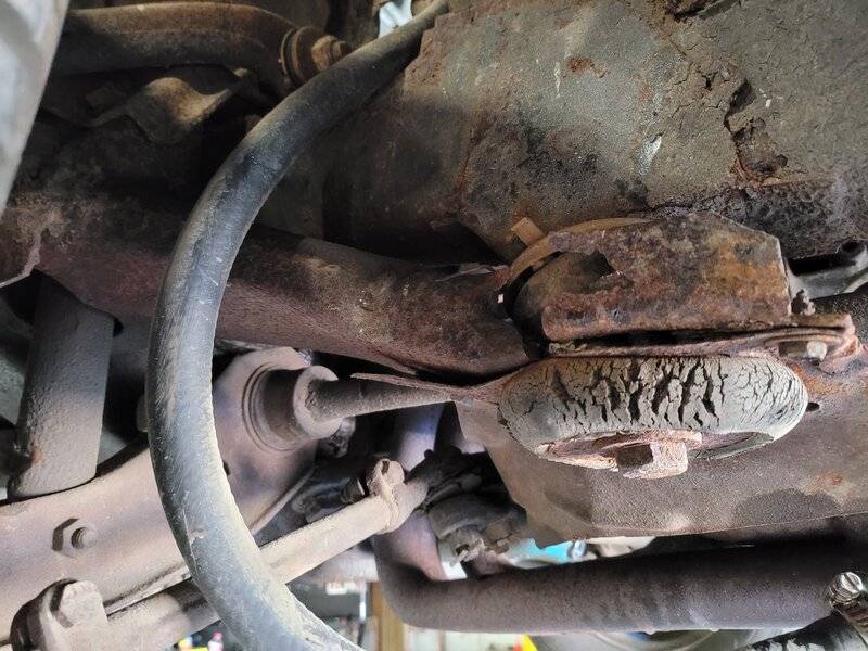

My K Member is rusted through on the drivers side near rubber bushing. Where can I find a new one or good used one? Any ideas? I'm new to this car and need help.
Anyone parting out a 73/74 B body can help? This is a pretty commonly available piece used but is not available new.

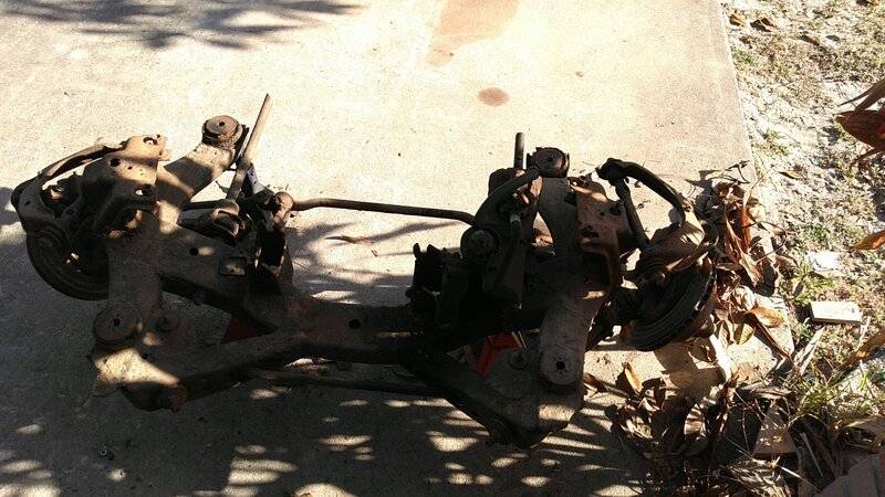

I have one sitting here was selling as a complete package for $400 with rotors and all but I could sell just the frame for $200 if your interested let me know probably another $140-150 to ship it to a business address
Or maybe you know someone in FL right now that will be driving back your way .
P.m. if your interested
Also this has a sway bar on it right now !
From a 73 rallye charger
Other than surface rust is it good solid condition? I would take the sway bar with it just to be safe. Let me know. I'm interested if its nice and solid. Let me know. Also just making sure it's for the small block V8.
