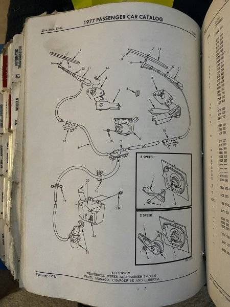

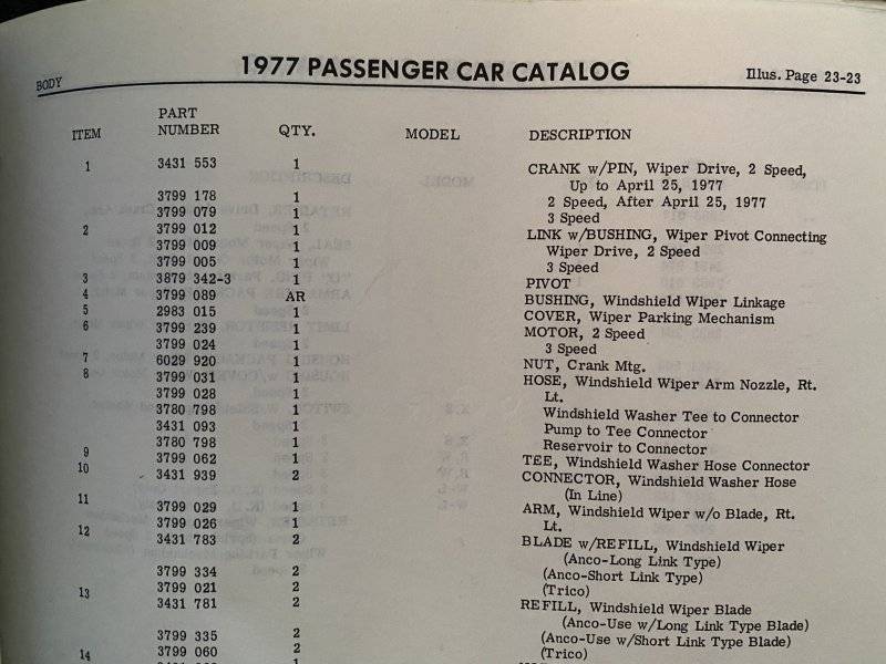

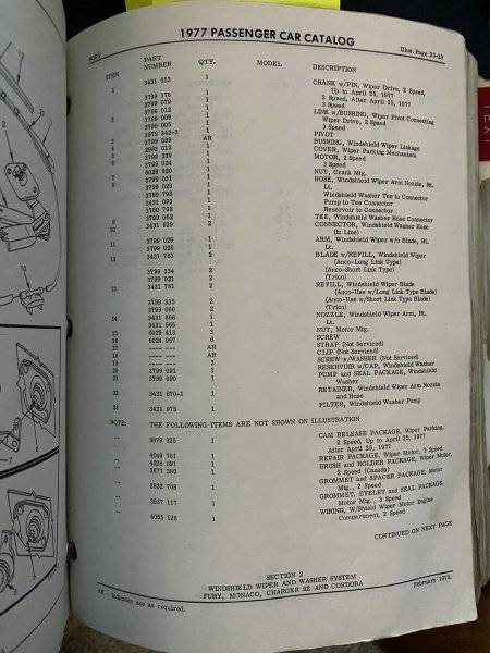

Looking to buy the Windshield Washer Line Connector for my 1978 Magnum. Not sure of the part number
Any other suggestions for those that have had similar issues replacing them.
Thank you for any assistance.
Is this what you're looking for? From my '77 parts catalog--I think the same as your Magnum.
