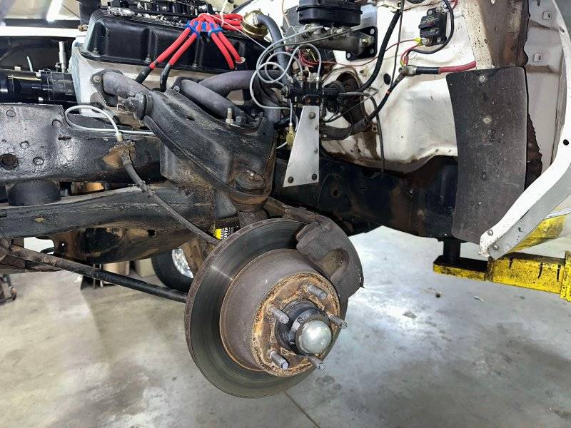

For those following the Museum page, you're already up to date on this. I purchased it a few weeks ago as I was searching for a bracket car to come back to drag racing. My nephews actively race and I haven't been in a race car in 15+ years. I always like the unusual, so why not go for a big heavy 300. It has a 408 setup on alcohol, power glide and 9" ford currently. When we got it, checked it over, changed fluids and headed to the track. The car was wildly inconsistent. With a lot of other things go on, we shelved it for about 10 days. We had some motors we were just going to swap into it, change converter and call it a day. Our spare motors had more runs than we anticipated and are now in the shop for full rebuilds. Eliminating their ability to hit my timeline of racing thanksgiving weekend. We don't have specs on the motor in the car, so decided to start pulling it apart. We took the carb off and realized it's massively over jetted. We have a 7.10's 1/8th mile car running jets that equal our Roadster that runs 2 seconds faster. We snagged a carb from our wagon race car as it's a similar build and put it on Moby just to see if that cleared things up. She ran like a top and got much tighter in the consistency area. With that problem solved, it's back into the shop for some repair work. The 9" is coming out in place of a Dana 60. If we have time, we'll rip out all the wiring and start over. All the brakes will be replaced and front end rebuilt. Might look at tying the frame together, we'll see. I'll post the updates here, hopefully you guys find them interesting. I may need to lean on some people for spare parts as there are some things I'd like to put back as it was from the factory. They went a bit excessive trying to make a whale a minnow.

It's in the shop now, we've found all types of fun issues. More to come. Yes, it was out of AZ. At one time was boosted, till it went boom I think. Then previous owner put a nice little 408 in it, but with a hydraulic cam, which we don't typically use. We're going to keep the gear at a 4:10 for now to keep RPM's down.
Good solid car with a straight body. I believe they lightened it quite a bit taking all the heavy braces out of the doors and the 5 mph bumper stuff that weighs a ton. Have you weighed it yet ?
3500 with no driver. We're going to put the Dana in which will add some weight, but changing the brakes out which will offset. By the time we add bars and with me weighing more than my nephews, probably 3700 with driver once we're done.

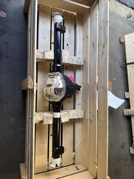

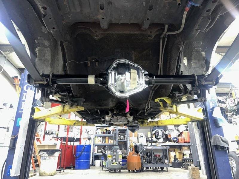

Ta daaa. New rear end in place. Dana 60 with 40 spline axles. Will get the drive shaft cut to fit. Lot of parts cleaning tomorrow. Dad and the boys are busy this weekend, so assembly of brakes and new/fixed suspension parts will commence on Monday. Once the back of the car is together, we'll drop it on the ground to check everything. Then time to tie the frame together and likely rewire the car. We have to do all of this by Thursday of next week. Lot of work to do!
