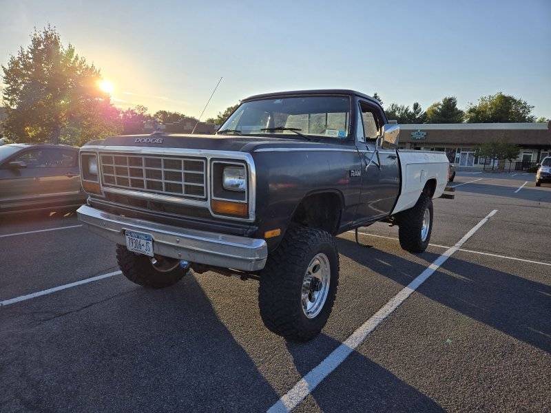

Got it yesterday.
Drove it in the morning, 1st granny gear no issues, 2nd gear seemed a little noisy, 3rd was very noisy, 4th was so quiet couldn't tell it was in gear.
I made an offer and that was my max. Took him a while, but he accepted telling me I was the right person for it.
Probably helped that I drove the Fury wagon there, hour and a half one way, love cruising that wagon.
318 was rebuilt, bored, cam, intake/carb/headers/etc. It sounds extremely healthy.
I did 65mph at 3k rpm the entire way home and it drove very nice, considering the gearing, tires, etc.
My friend who took me there and followed me home said I was doing 80mph+.
Guess the speedo is off a bit.
Basically everything has been done, and of course it has a few issues.
Trans (unless those trans are supposed to be noisy), no pads on the clutch/brake pedals, driver door needs adjustment, bed needs to be leveled out on the 3" lift, need to find a few pieces of trim, need a longer drop hitch, an aftermarket trailer brake plug kit, blah blah blah.
