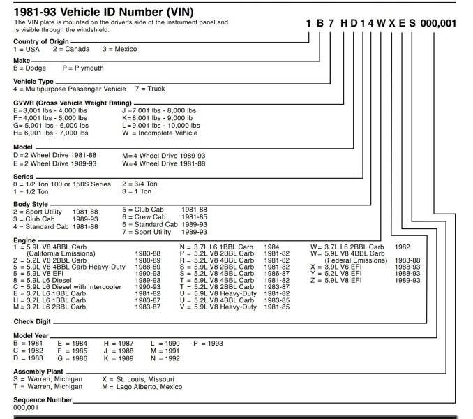

Researching the 81-93 Ram trucks and looking to see if anyone here can fill in the blanks.
I know the VIN has info like Model, Year, Series, Engine, but what transmissions and axles were available?

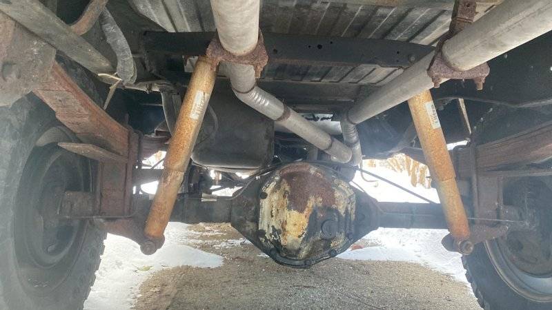

I have a '84 w150 318, but with a 727, so can't comment on the 4 speed, it will have a 9.25 rear end and a dana 44 front, my truck has 3.23's
(edit) after digging around it looks like a new process 435 would be what's installed in the 4wd's, granny low with 4th. being direct.
Looks like rear is a Dana 9.75.
must be a W200 or 3/4 ton with floating axles,
a W150 1/2 ton usually doesn't have a Dana-60
9.25" has 12 bolt cover
9.75" has only 10 bolt cover

dana-44 & dana-60 (even a dana-70) pans look a lot alike/shape wise
the dana-60 is physically much bigger

So the 6th digit of the VIN, the Series, will tell me if it is a 1/2, 3/4, or 1 ton.
And a 3/4 and 1 ton would come with the Dana 60?
What makes it a 3/4 or 1 ton, something about the frame, axles?

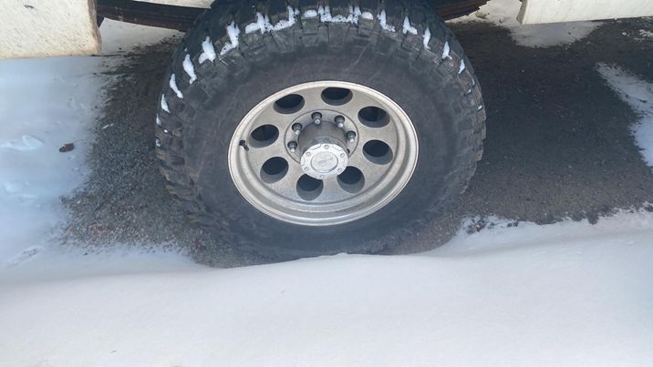

Looked at the truck.
VIN is on the dash, the sticker on the door jamb, and the sticker on the underside of the hood, all match.
Hood sticker has a code that has AUTO TRANS after it.
According to the VIN, 1B7FD14T3ES:
USA, Dodge, Truck, 4-5k lbs, 2WD, 1/2 ton, Standard Cab, 318 2bbl, Check Digit, 1984, Warren MI.
The cab and front sheet metal are clearly from the same 2WD truck, the bed is from another truck as it is a different color.
Both are rust free.

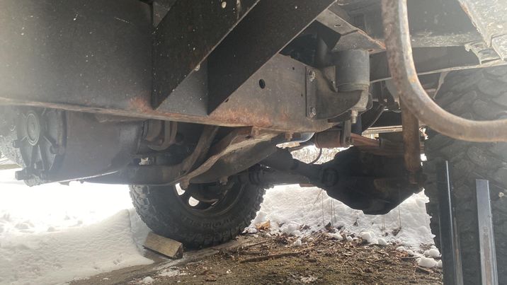

Chassis has Dana 44 and Dana 60, 8 lug wheels, 318 4bbl, granny gear manual trans.
What I cannot figure is what the chassis is from, a W150, W250, or W350?
Or is it a 2WD chassis converted to 4WD?
I don't really care if it was made into a W250/350, just trying to figure out what it is.
Current owner bought it a decade ago from someone who could not finish.

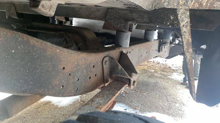

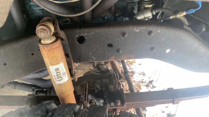

This last picture by the shock, is that an oil drip line or a crack?
People used to get donor trucks with the heavy axles and swap onto half tons for "mudding" around by me.
It could also be a junky 250 that they swapped the body over onto. Personally taking a 2wd half ton with an auto and turning it into a 4wd 3/4 ton swapping mechanical would be a lot more work than moving the body onto a chassis. But I know people that did it in their youth, usually Chebby guys, Ford guys around here dreamed big and never put their truck back together LOL. Not enough stuff is compatible with the Fords.
Snow melt.
Yeah, I think the body was swapped onto the chassis, not by the current owner though.
It is very clean under there, I was crawling all under it, no rust or rot.

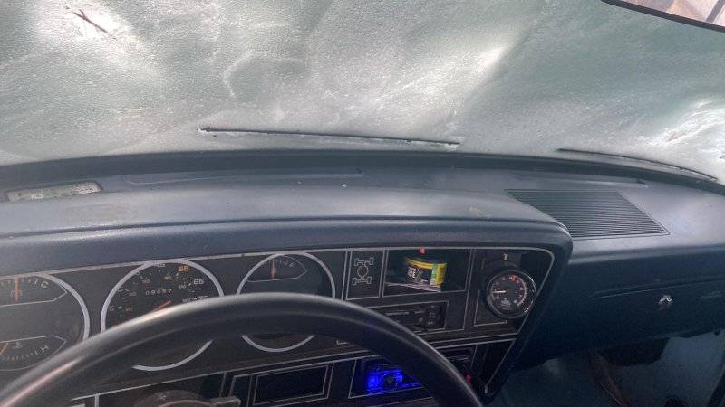

It's got one hell of a body lift kit on it, I'm guessing the cab still has the small tunnel from when it was 2wd.
Can't tell what transfer case it has, hopefully not the full-time 4wd one and it has lockout hubs up front.
Looks like dana 60's front and rear, probably 4.10 gears in it.

Small tunnel, not sure, best pics I have of the tunnel, pic of the floor/rocker too.
