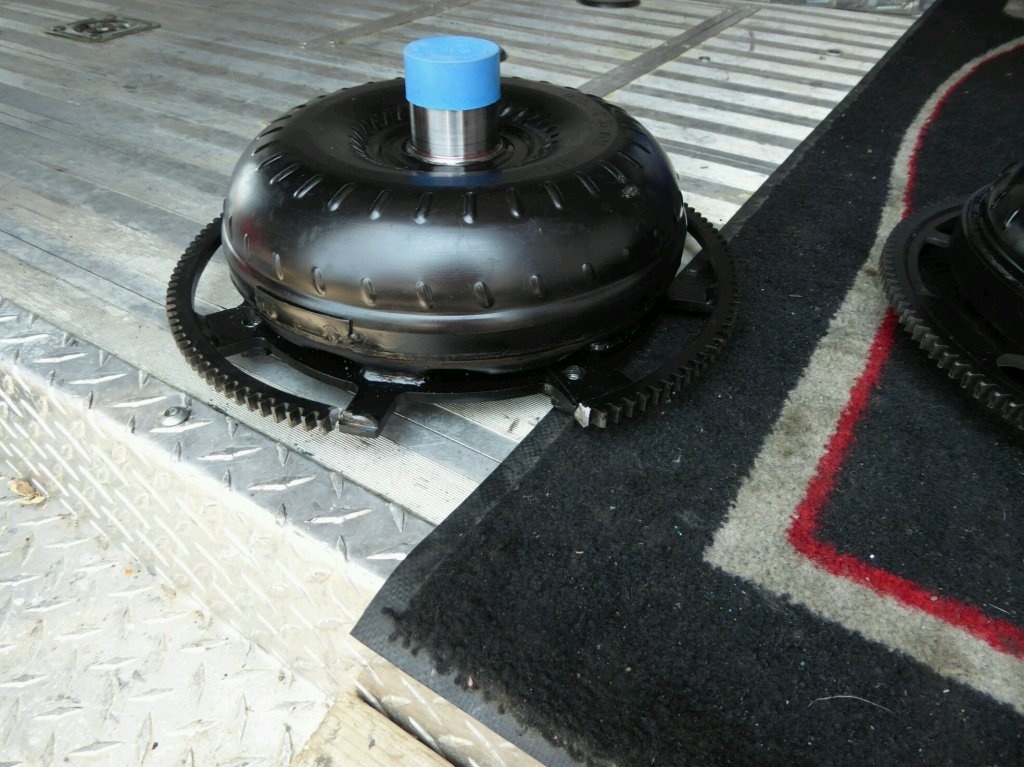

Car was very good. Qualified #7 out of 60 cars. Ran for class on Saturday went to final 5 out of 19 and went brain dead -.064 red. Then starter issues. Pulled the starter 4 times. Moved the crank and it started, then no crank, starter just spun. Late and dark put it away. Started Sunday to warm up. Then wouldn't crank again for the 1st rd. In the daylight I could see the issue. Missing 4 inches of ring gear. Shouts out to Jeff Freese for letting me use the hoist in his stacker to swap out the converter. Good to go for next weekend in Columbus.

Man, How the heck did that happen?

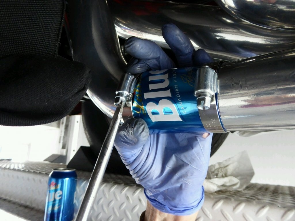

Came back from a run and the starter just spun. Have no idea where the missing piece went. I can tell you it became friendly with the header tube on it's exit. Fortunately no other damage. It's in the trailer ready for Columbus

never seen a starter ring do that, learn something new everyday
love the beer can patch job...LOL
