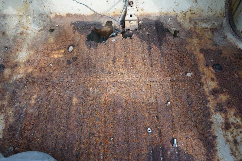

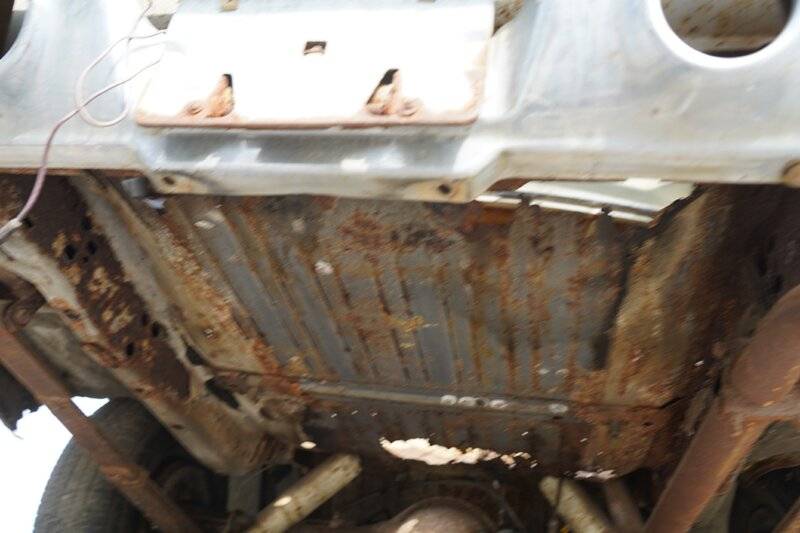

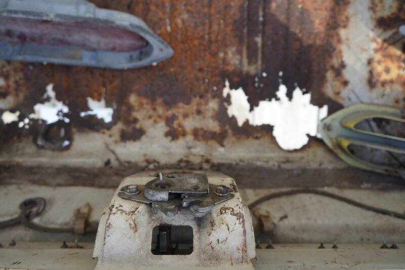

I just know the next question is going to be for pics, cuz you guys like pics! Warning ugly pics ahead! The rest of my car is surprisingly solid or I would not have bought it. This pan and tank are all about it needs to be solid. ( OK rear quarter patches too but they are not a priority right now)
