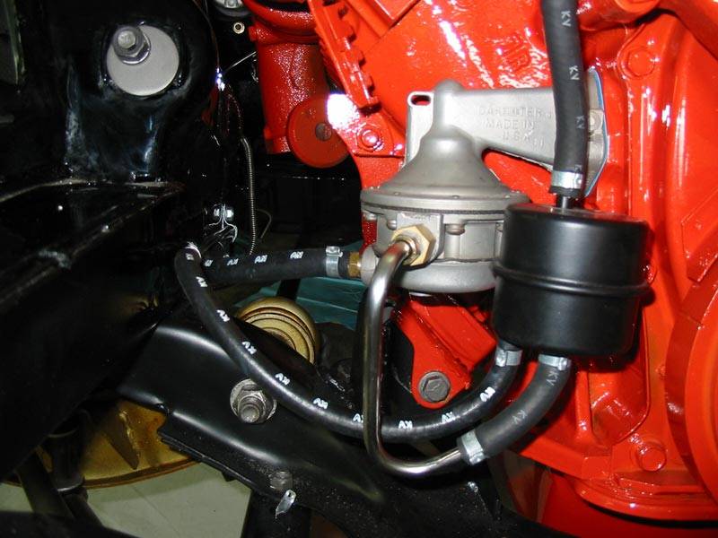

This is routed behind the heater hoses
Connects to the fuel filter next to the fuel pump with 5/16" hose

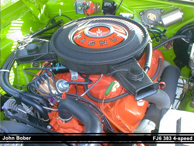

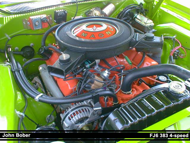

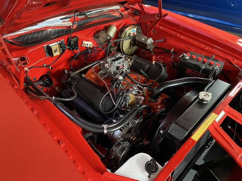

383 cars used a dual nipple fuel pump for inlet and outlet - 5/16" hoses on both
The smaller steel tube or fuel line wasn’t used on the 1971 383 cars
Was used on the 440 cars like posted with fuel vapor separator
