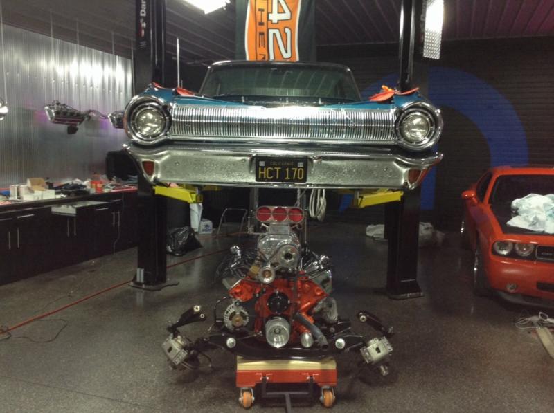

I have no need for an excavator, nor am I ever going to ever do a lift kit. For me, the 4 post lift works out fine. I'm even able to drop the body down onto the K-frame & drivetrain.

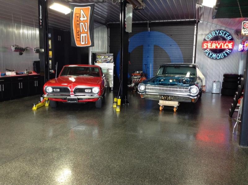

How about your garage is like out of a dream, for fucks sake, I want a pillow and silk sheet, I'll sleep on that floor. I am in love.... I cant have anything that nice because I am a pig, Ill turn a track machine around in there and destroy it all, dam it... I want to pour jelly beans on the floor and make snow angels in there...
4 post with "chirp" strips.
Good for second car and with a jack plate easy to work on anything.
Thanks, it took about a year to get it the way i wanted it... ("pay as you go plan") it is a working shop however. Plenty of scratches on the floor but i can appreciate what you're saying about the track machine. THere's a 30x60 pole bldg behind that big overhead door that isn't heated where i have the mowers, tractor, backhoe, etc...
I literally spend 90% of my free time out here. It helps to have a 30'x40' "apartment" attached. Only time I go in the main house is to sleep and when DW makes dinner.
The last thing to go in was the lift. Best addition to the shop; bar none!

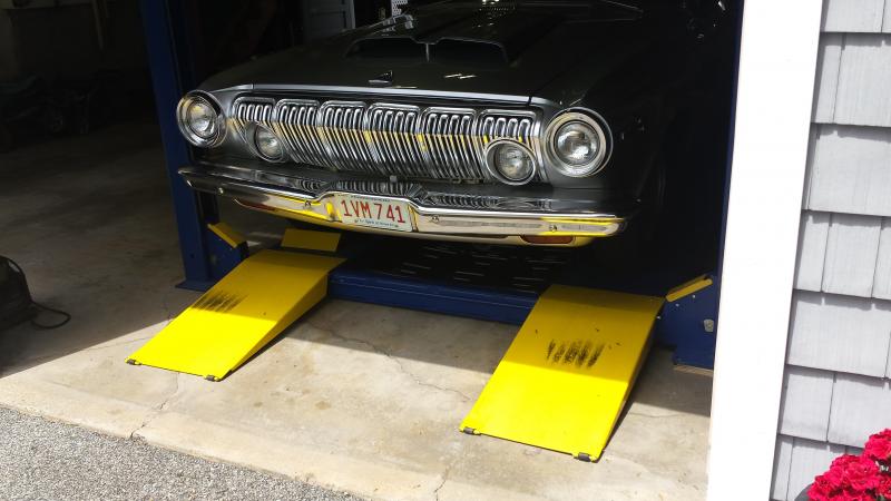

Please correct me if I am wrong but I believe that you have posted pictures of your cars on both types of lifts. Maybe posting those pics showing the different applications they could be utilized for?
I have a 4 post drive on lift at my Dad's house which I have used for restoring four cars now. While it is easier to do a front end using a two post lift, I have been able to do it using the four post ramp lift. The nice thing about the 4 post lift is that we double stack our cars in our garage allowing 3 cars to be in a 2 car garage.
