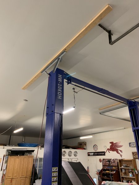

Didn't trust my floor with a relief cut very close to one post so I joined the post tops.

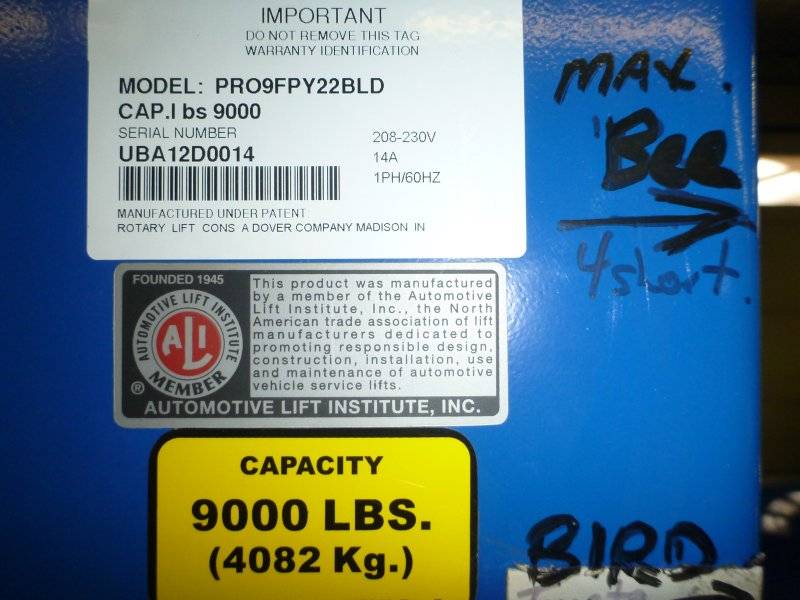

I have a 9,000# Rotary with floor plate. I purchased it 23 years ago at a auction ($2,000), it was old then, and I had figured a lift before pouring my concrete. I do find the plate to be troublesome when pulling trannys and doing oil changes but I still love it! The hoist was installed in a Dodge dealership-over a basement! They did have an old screw type press with blocking to support one post. I have 12' ceiling and the rams just kiss the ceiling steel at full extension.

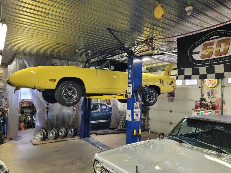

Here's my cheap chinese "Direct Lift" 2 post lift, it's manufactured under Rotory Lifts Patent and I bet their major components are made in China as well and just put together in Indiana..
