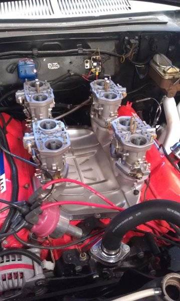

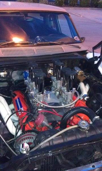

How about webers,never seen anyone try this. Hood clearance is an issue even with short stacks been doing some research on this set up.
dodge3.jpg 534250_3850094125847_1083052874_33507149_1501736811_n.jpg dodge2.jpg
just check your hood clearance, this manifold looks similar to the performer RPM in height, I had run an offenhauser dual quad with two 600 cfm carters worked great. I run an performer RPM dual plane single carb on my 67 GTX and have to run a drop base air cleaner http://www.edelbrock.com/automotive/mc/manifolds/chrysler/dual-quad-bb.shtml

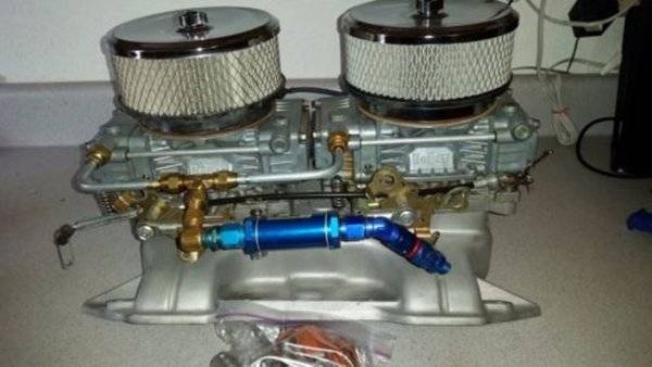

OFFENHAUSER ALUMINUM 2x4 BARREL INTAKE WITH 2 HOLLEY 600CFM TUNED CARBURETORS, CAME OFF OF A 500HP MOPAR 440 . READY TO INSTALL COMES WITH MOUNTING BOLTS, RETURN SPRINGS, BRACKETS, ACCELERATOR CABLE, THRODLE LINGAGE, FUEL FILTER, MUST USE GASKETS THAT BLOCK OFF EXHAUST PASSAGE WITH THIS MANAFOLD!
