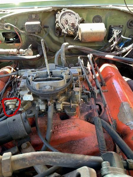

Also is the port on the carb visible in the picture i attached to the first post?
17-18" of vacuum is OK for V-8s. The small choke pull off diaphragm (right front side of carb) can be unhooked at the carb and that nipple will provide manifold vacuum to your gauge.
I'm a bit confused because you say right front side of the carb but after some googling i think you mean the thing i marked with a red circle?
And if i'm understanding correctly the vaccum line that is connected to that is also connected directly to the carb and i remove it from the carb and then plug my vaccum gauge there, right?
Correct. Sorry, I should have said: the front of the right side.
