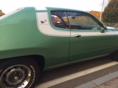

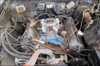

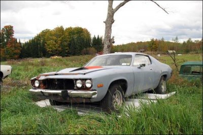

This 74 RR was found in a field in Vermont where she was to spend her last days until I brought her back to life last time on the road according to original owner was 1994, this car needed everything rear quarters rockers inner outer wheelhouses etc, I attached a few pics of before and afterView attachment 288193 car in field.jpgcar in field 2.jpgimage1.jpgimage2.jpgimage3.jpgimage4.jpg

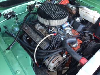

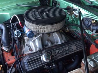

Here's a few more pics

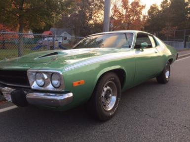

went with original color frosty green metallic,
Very cool car my friend and great save too!

as you probably know it's next to impossible to find sheet metal for a 73 or 74 especially quarters, I got 2 quarters off a donor car from new mexico but they were rough, I used front and rear lower patches from AMD, the front patch is from a 72 and required a little work to get the lip to line up,but they worked fine also used rockers for a 72 from sheerwood ,but I had to modify a bit to fit well, every thing else I had to fab
