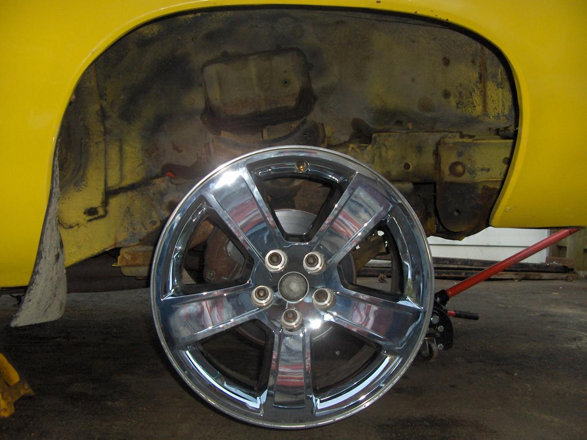

The bolt pattern is very very close, you can do it, make sure you tighten 'em down good, and you should be ok,
The hub/center of the wheel is a hair to small and will not fit over our rotors with out some work, a custom bearing dust cap will need to be made because the stock one will be in the way of the wheels center cap.Been there and done it :)
????? The positve off set on the late model wheels will push the rim/tire WELL into the well and most likely interfere with the brakes. If you got the time and money you can do just about anything but this will be no bolt on. In the link provided by Donny, the wheels are by Boyd and I will certainly bet they have the proper off set and back spacing. IMO
Mine clear the breaks and every thing else fine.Like I said the Cap is the only real problem.
Donny didn't post a wheel link? I did tho, it was just to show the tire size they used.
Nah, didn't have a link to post! Just talking experience here, took 'em off my wife's Charger (18s) and put 'em on my GTX as an 'experiment'.
