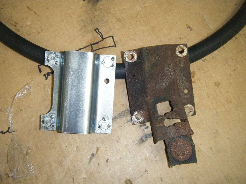

i am running a duel exhaust on my 73 340 challenger all i see is only left side exhaust hanger is it known to put a left bracket on the right side?
will need to drill holes to mount the right side if i use a left bracket
am i missing something on a duel exhaust exhaust hanger bracket
thanks all sjm
70 & 71 used the bracket you posted... By 72 they had gone to an arraignment that mounted to the shock crossmember...
I don't believe it is reproduced... If it's missing your best option is buy the 70-71 style bracket & drill the holes, there are dimples in the floor pan so accurately locating the holes is easy..
